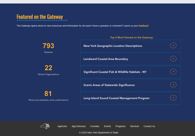

We built the Python Notebook approach to populate the stats for the Experience Builder embed at the bottom of this page: https://opdgig.dos.ny.gov/pages/engage
Screenshot 2023-12-05 at 5.30.04 PM.pngScreenshot 2023-12-05 at 5.30.04 PM.png
Reach out to @mhaley_stone_env if you need more deets than the general idea.

This is a great question! @NFlourish has a nice suggestion using the Python notebook to call the DCAT feed or the OGC API.
That said, we should make this easier within Hub. And fortunately we're working on it! Let me share what we're thinking and see if it fits this need (and others).
We've been updating the Summary Statistic card. Currently you can see the new design and includes the long-standing "Dynamic Metrics" and "Static metrics".
We're working on more sources including what we're referring to as "Delegated Metrics". These are counts of statistics from other Items. This could include "count of items of type Dataset", but also "sum of downloads of type PDF" or "sum of views of Apps tagged 'trees'".
Please let us know if this concept and terminology makes sense to you for this use case.
And to @NFlourish screenshot - we can consider summary statistics on Groups / Users as well as "gallery" configuration that sorts by these attributes (most download, most viewed, ...)
