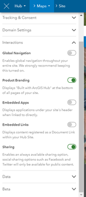

@BrianRollison  I am also still not getting this to work.  In unchecked everything in the app settings. Thoughts? I want web apps to open with the header or at least with out the large Side Panel, which seems to lack any way to close or minimize it. (If I could at least minimize it as a user that would be ok but I would rather jut not see it at all. And Users can use the browser Back button if they want to go back to the Hub)
BrianRollison
Hi @KevinMacLeodCAI -- when the "Embedded Apps" capability is turned off and you publish your changes then all "App" item types (such as Web Mapping Applications) should open outside of a Hub Site.  I've confirmed this is still the case on production, double-check to make sure you published changes.
Related to the side panel, we actively considering updates to the panel display.  You can minimize while viewing the app, web map, or dataset by selecting the "Info" icon on the right side of the panel.  Question for you, is having the panel closed by default unique to applications or something applicable to all content types (i.e. PDFs, Datasets, Maps, etc.)?
