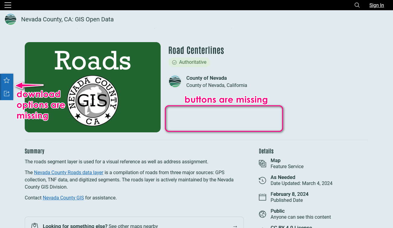

We recently had someone from Canada report that they couldn't download data from our Open Data site. We verified that they can see our rest endpoints, but when they sent us the screenshot of what they are seeing on our Open Data Hub site on AGOL, I was surprised to see there are no Download options on the left blue tab, nor are there any buttons to the right of the item thumbnail.

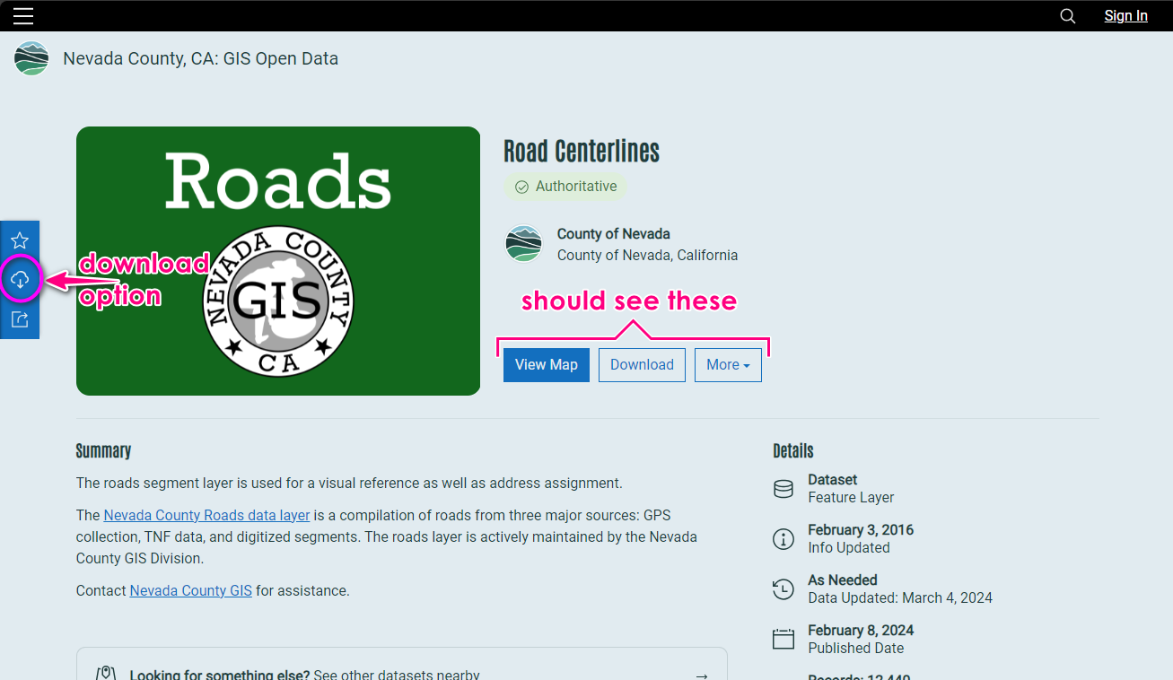

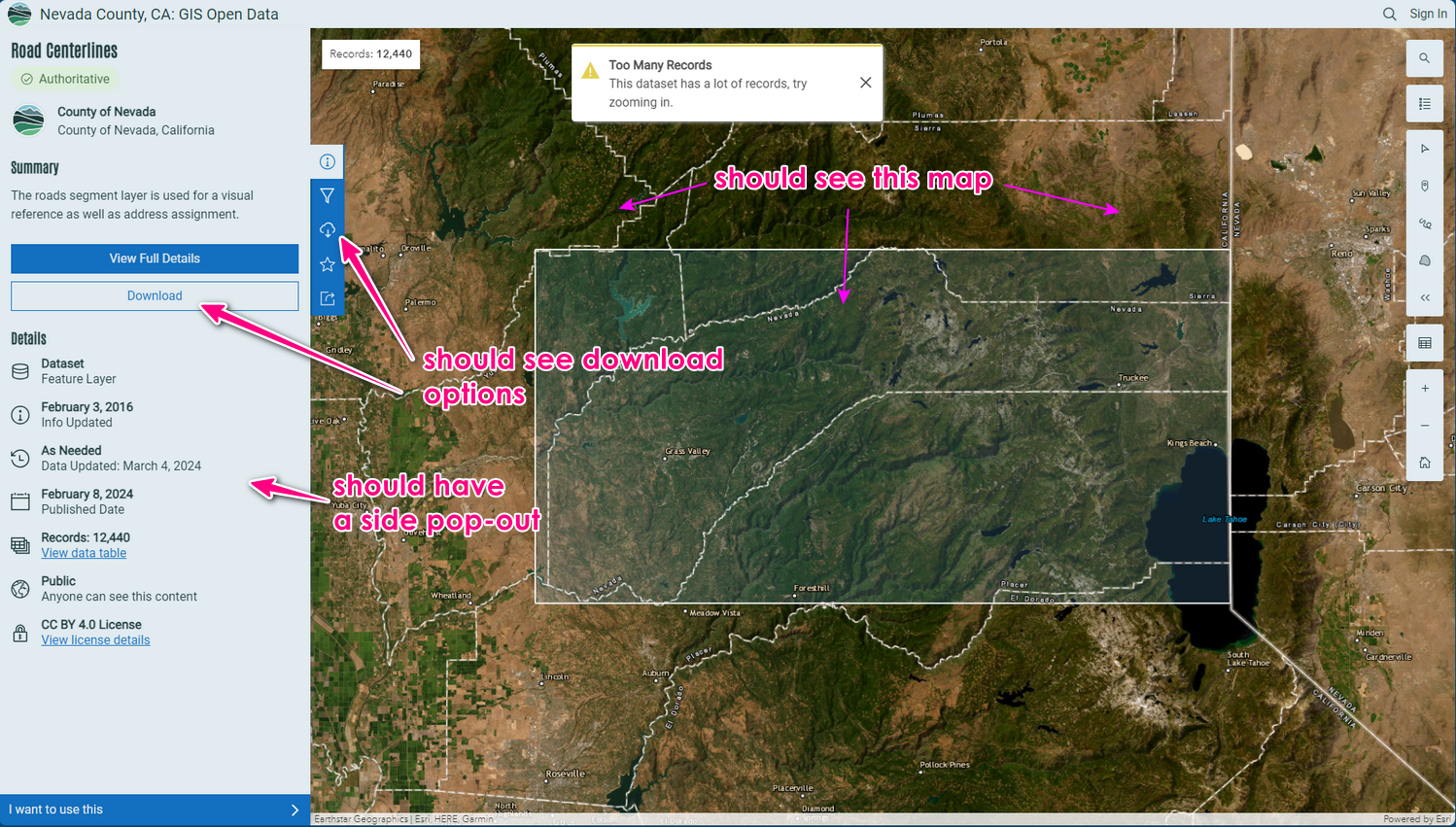

For example, our Road Centerlines offering, when you click on it should land you on a page like this:
Instead of that, they end up on what appears to be the 'about' page, but it's missing some key components:
This is what that about page should look like:
Anyone have any idea why they would be seeing a different page, and one that has no download options?

Hi @alex_friant ,
Are you able to share the URL for the view that does not have any download options for me to investigate? In the screenshot above it appears that this a Feature Service item with no layers. There is a subtle difference between the two namely that the view without any download options is a Feature Service item.
Typically, service items do not have a direct download option, but selecting one of the child layers would bring the user to the /explore view of the layer with options including downloads. We'd need to investigate why the Feature Service item does not have any layers to select.

I did notice that, too. Even though it's the same item which points to a FeatureServer rest endpoint, their landing page is showing a "Feature Service" and my about page is calling it a "Feature Layer". That they are different makes no sense because it's the same item on AGOL.
I assumed the URL for their landing page was the same as the one they clicked on: https://maps-nevcounty.opendata.arcgis.com/datasets/504d7ac45ee3469fb0f0dbc8b00a3c09_1200/explore?lo...
But I just asked them if they could send me the URL of their landing page with missing buttons to see if it's getting changed somehow.

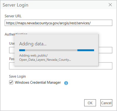

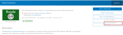

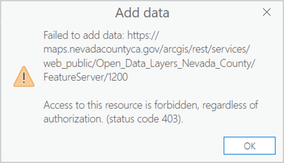

Hi Alex,
I am located in Canada and the same occurs for me. There are not download button from the Road Centerline item's page. Furthermore I tried to open the data in ArcGIS Pro via the ArcGIS Online Item's Description page and ArcGIS Pro keep on spinning when authenticating.
And, If I cancel I get a Forbidden 403.
Hope that can provide you some additional things to look at.
