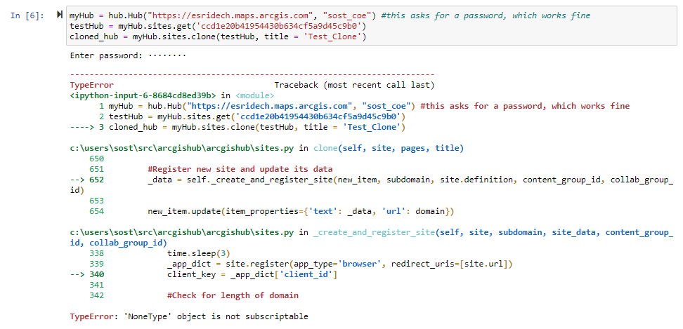

I was just trying to clone one of my own (and public) ArcGIS Hub pages using the ArcGIS Hub API. However, I kept running into this error.
The new object is actually created including hub groups in the subscription, but not filled with content.
Has anyone seen this before and can give me a hint what the problem could be?
By the way, I am using Jupyter Notebook (Python 3).
by Anonymous User
Not applicable
Hi Sophie,
This was an issue in the Hub Python API but has been fixed now. Are you working with the the most recent version of the API, i.e. have you installed/upgraded it since the last week?
