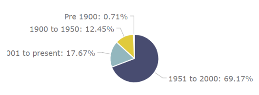

Right now, one of our pie charts looks like this:
I'd like to remove all decimal places from the percentages so that 17.67% would become 18% and 0.71% would become <1% (if that's possible).

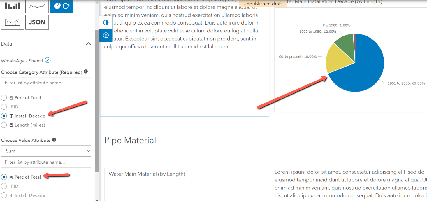

If that level of control doesn't exist on the labels, I'd alternatively like to try setting the value attribute in the Pie Chart wizard to Perc of Total like so:
This accomplishes the task of rounding the percentages, but I'd still like to get rid of the trailing zeros in the percentages. Can that be done with the override property in the JSON configuration?
If I end up going this route, then what I would need is to have the values that are displayed when I hover over the pie chart wedges to be a different value field than the Percent of the Total. Right now, when I hover over a wedge, it shows the same Percent of Total values as are shown in the labels.
Is there any way where I can set up the pie chart to have the labels as the Percent of the Total (as is shown in the second image above), but when you hover over a wedge it shows the values from another field? In our case there's a Total Miles field that's being summed up for each Install Decade that we want shown when you hover over a wedge.
