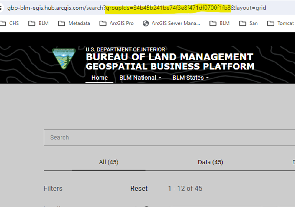

Go To a search with a group Id parameter: https://gbp-blm-egis.hub.arcgis.com/search?groupIds=34b45b241be74f3e8f471df0700f1fb8

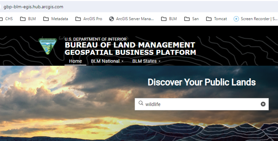

From there, go to the Home Page and Search for something...

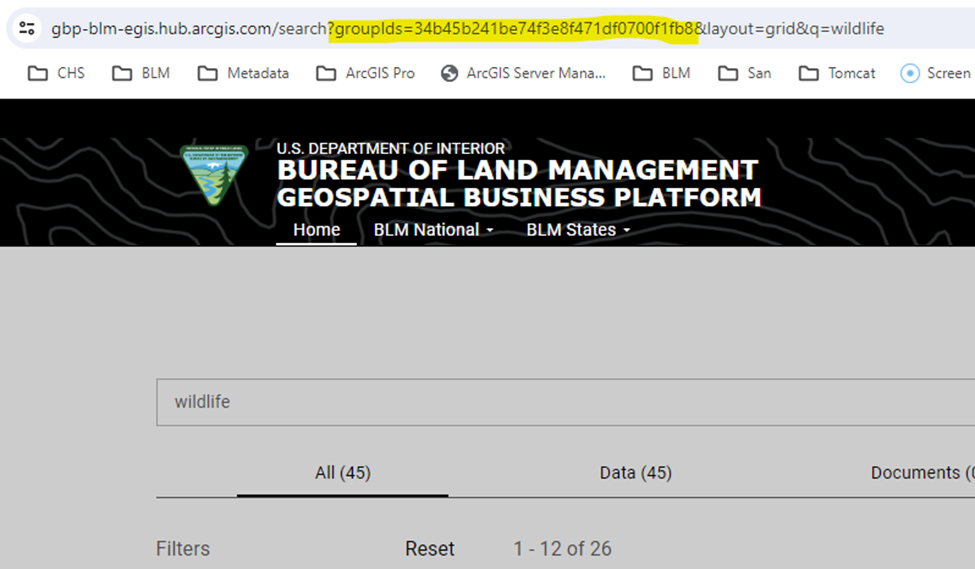

The groupIds parameter persists...
The issue seems to be NOT clearing out the groupsIds parameter. The search parameters ARE persisting when moving from search pages with the new search experience.

Thanks for your post. We've identified the cause of the issue and we're working on a resolution as soon as possible. Please stay tuned to the Hub changelog. Once complete, when a user executes a new blank search from a different part of the application (such as the global navigation search bar), then previous filters including groupIds will be removed.
Given that many customers use group filters explicitly to show end users a smaller subset of results but the values are not clear to end users, we've intentionally obstained from adding a filter for groupIds. However, as you've noted the filter should be reset when executing a new search.
