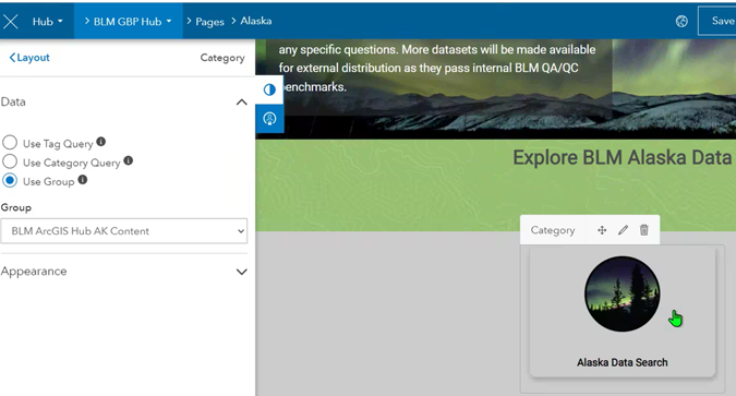

 We have used the out-of-the-box configuration to set-up our Category Cards to use “Category Query” on our main Hub page.
And on our State pages we “Use Group” on the Category Card.

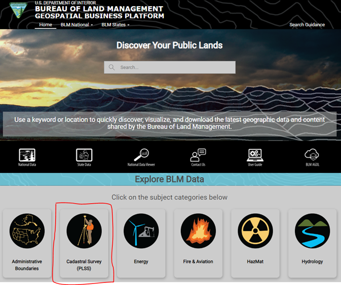

From our main GBP Hub Page: https://gbp-blm-egis.hub.arcgis.com/
If I click on the Cadastral Survey Category Card…
I see 83 search results from various levels of the organization (CO, NM, etc.).

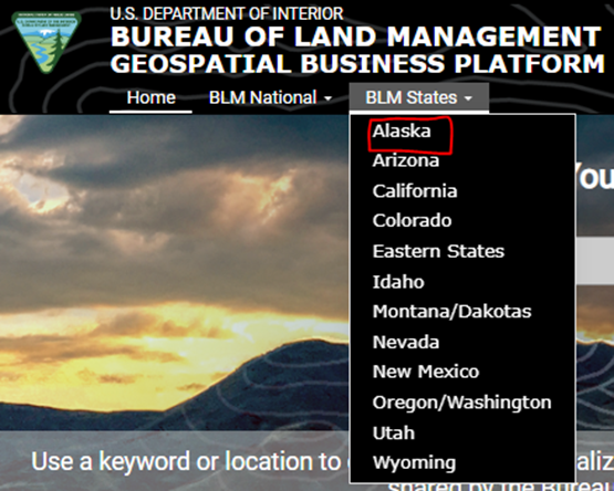

From there if I navigate to a State Page like Alaska:
https://gbp-blm-egis.hub.arcgis.com/pages/alaska

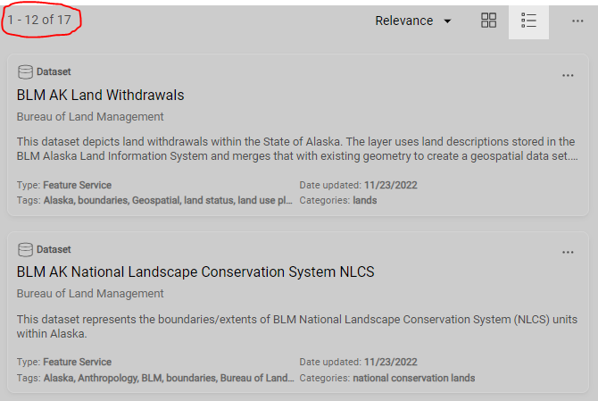

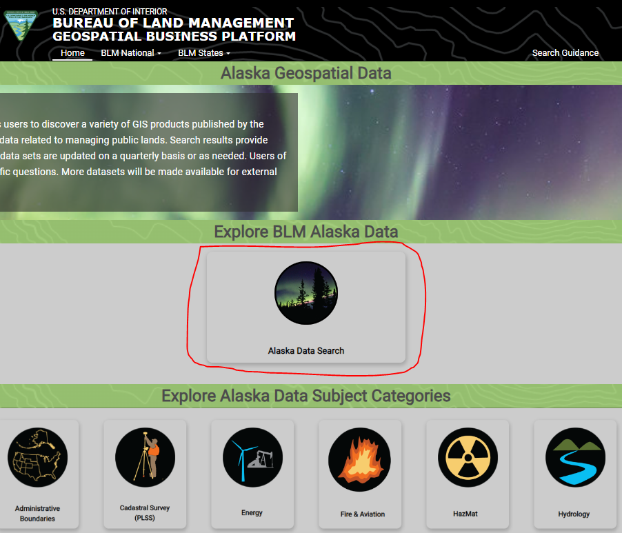

Then click on the Alaska Data Search (Category Card) (on the Alaska State Page):
I see 17 search results from Alaska: https://gbp-blm-egis.hub.arcgis.com/search?categories=%252Fcategories%252Fcadastral&groupIds=a068034...

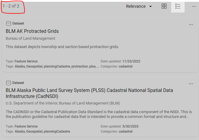

BUT then if I go back to the main GBP Hub Page again: https://gbp-blm-egis.hub.arcgis.com/
 And click the Cadastral Survey Category Card…
The result is 2 search results from Alaska, instead of the 83 search results I would expect to see on the main Hub Page (which should be everything under that category for all states – 83 items!)
It appears navigating back to the Cadastral Category on the Home Page is now a combination of the previous Group Query and the Cadastral Category Query. That's why we are only seeing 2 records when we would expect to see 83 records, because it should just be showing the Category Query (not the Category and Group Query).
