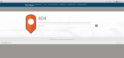

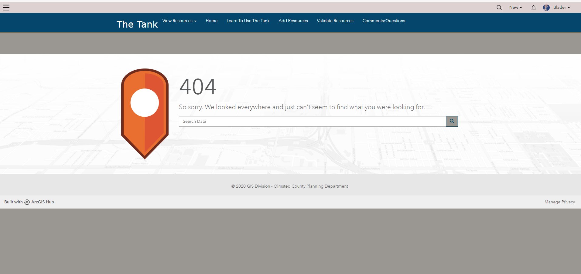

This link used to work to open a private Survey123 survey as a content item in a Hub Configuration. Now we get error 404 with the new Hub release. (I am the creator and owner of the content).
https://the-tank-gis-olmsted.hub.arcgis.com/app/5e61e856baf54c6d807fd0af27bc1e72
The survey opens via Survey123 no problem (it's a private survey).
This was used in a customer header in a menu item, but also in a gallery item and a card item and both cause a 404.
This is also an issue with a StoryMap that is shared within the gallery or a card item in the Hub Configuration. However, sometimes the StoryMap appears sometimes there a broken page icon error. It's not consistent and so it's a little confusing. Using Edge is that matters
