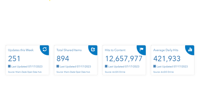

I came across this Hub site.
  1. How can I create the flip card widget(s) shown in the screenshot?
  2. How can I link the flip cards with GeoHub and AGOL to get these numbers?

Those are not flip cards. Those are non-dynamic KPI cards from this post: https://community.esri.com/t5/arcgis-hub-documents/tips-create-custom-cards-with-html/ta-p/920496
Flip cards are actually rather challenging to get right from a keyboard accessibility and focus management standpoint (we've tried), so it's unlikely you'd seen those in our editor.
As for having a dynamically backed statistic card, we currently support this today with the statistic card in the layout editor. We are, however, working on some improvements to that card, which will give it a little appearance boost, amongst other requested features. You can expect to see these changes during Q3 this year.

Thank you for the quick response, I always appreciate that. So with the statistic card, how can I can connect it to my organization's GeoHub and AGOL to retrieve similar numbers as shown in the screenshot?

Assuming you have the data in your catalog, you should be able to follow these steps https://doc.arcgis.com/en/hub/sites/insert-charts-tables-and-key-metrics.htm#ESRI_SECTION1_E1D799DC4... to connect your data to the statistics summary card.

Oh so there's no direct way to connect the card to AGOL to get such numbers? I will first have to get this info from AGOL into an Excel document and upload it to AGOL and then feed this as an input dataset to the card?

Yes, the only way to have a dynamically updating value is to connect the data as a feature layer or csv to the Hub statistic card. If you're asking for a way to manually enter values, that will be part of the Q3 update.
