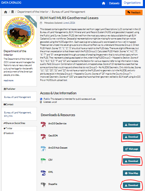

What we are seeing is a discrepancy between the DOWNLOAD links from the HUB GUI, and the HUB default JSON feed DCAT-US 1.1 (for Developers) is currently not putting a valid link in the JSON to download SHP files.
For example, the DOWNLOAD links below are for this item:
This link Works:
(This URL uses the Open Data.arcgis.com API, AGOL REST API V3, well documented)
This link does NOT work:
The default Hub JSON Feed DCAT-US 1.1 uses this URL for Download – Shapefile: https://gbp-blm-egis.hub.arcgis.com/api/download/v1/items/217c8e3ac8b142b88218f3dfef15542f/shapefile...
(This URL uses the HUB API V1, not documented)
The link being generated from the default HUB JSON doesn't work for 'Referenced' feature services from 'stand-alone' Enterprise Server (ArcServer). (We are still at ArcGIS Server 10.9, and hope to migrate to 11.3 in July).
Our QUESTION is: Why aren't you using the link from the HUB DOWNLOADS in the default JSON (DCAT-US 1.1 feed)?
In summary, the default JSON feed (for Developers) currently is not putting a valid link to DOWNLOAD SHP files in the JSON.
Is ESRI going to fix this, or do we have to develop our own fix for the DEFAULT HUB DCAT-JSON 1.1 to include the links from the HUB GUI Download operations?
