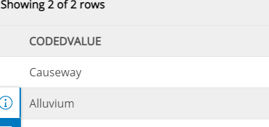

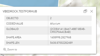

Can anybody help please ?..  We are just amassing data for publishing to HUB via AGOL collaboration with our Enterprise and we are testing functionality end-to-end and I appear to be either missing some logic or it is not available ? Coded Values for export.  Our Datasets are geologic in nature so have a lot of coded values / descriptions for data management and quality, in Pro and Enterprise (webmaps, tables etc.)  I can see coded values and descriptions and export either or both for the end user, however when the dataset is shared as a feature service and share with hub I can still see  coded values and code description in the table whilst on HUB, but if I export the data I can only get the coded value and not the code description - this description is critical - is there anyway to get this to export for the end user otherwise the data is not immediately useable effectively ?  I ideally would like to not have to store the description in another field either.
example   A = coded value  Alluvium is the coded Description
and the geojson (same for shape etc.. ) has 'A' instead of Alluvium
