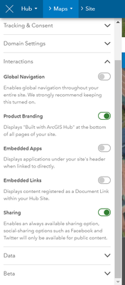

@BrianRollisonthis particular setting seems to be gone.  In unchecked everything in the app settings, below. Thoughts? I want web apps to open with the header or at least with out the large Side Panel, which seems to lack any way to close or minimize it. (If I could at least minimize it as a user that would be ok but I would rather jut not see it at all. And Users can use the browser Back button if they want to go back to the Hub)
JustinPrather
Hi @KevinMacLeodCAI –
That setting name has changed since last year. It's now labeled as "Embedded Apps".
Embedded Apps toggled-on will open applications in the context of your site. Toggled-off, it will open apps in their native application (e.g. a Story Map would open with a Story Maps URL).
As for the side panel on the left-side of the page, you can minimize this side-panel per page by pressing on the "i" (information) icon. Are there specific types of content that you don't want to see the side panel? Are there some types that you are ok with seeing it? If you can provide additional feedback about why you would like to minimize or remove it, that would help us. Thank you!
KevinMacLeodCAI
@JustinPrather thanks for the rapid and detailed reply!
Indeed I have already un-checked that (in screenshot) and it did not seem to have any effect. Thoughts?
I think in most cases, I do not want to see that or have it expanded by default. So maybe only in very select cases would I want it, and none that I can think of, at the moment. Apps usually have all the 'About' info, metadata etc already in them. Usually we put that in the About widget or a link in the header to more info for example. And so I want to make that hidden for users by default on my Hub. Not requiring them to click the minimize.  Frankly, I don't even want them to see the Minimized panel.  I'd like to see an option for that to just disappear completely after a given amount of time (i.e. 10 seconds or customizable).  Maybe if the user mouses to the left, show it. Or reloads. But really, at the end of the day I view it as 100% unnecessary in most situations; and confusing to end users.  My goal is if they want to go back to the Hub, they can click Back. If they want to see info about an App, it will be in the About widget or back on the Hub page. Thanks again!

KevinMacLeodCAI
Hm, I believe I had published. And it was still happening. However, it is not happening now. Maybe related to the June update? Anyhow, it now seems to be working perfectly as intended, looks like case closed! Thank you for the reply @JustinPrather

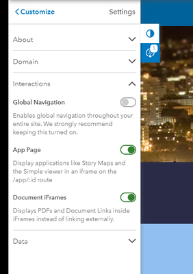

GIS_System_AdministratorSunshi
HI There
Just wondering what version you were using? We have just upgraded to 10.8.1 and I am getting the same issue. How ever my dialog box doesnt appear to have the same options as you had. See attached.
I tried switching off App Page but this didnt make any difference.
Any suggestions would be great.
