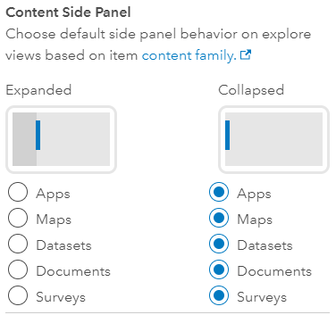

In your hub site go to Settings -> Interactions -> Content Side Panel
Set the side panel to 'collapsed' for anything you don't want the sidebar to appear for.
Example:
Example:

Thanks @DataOfficer !
