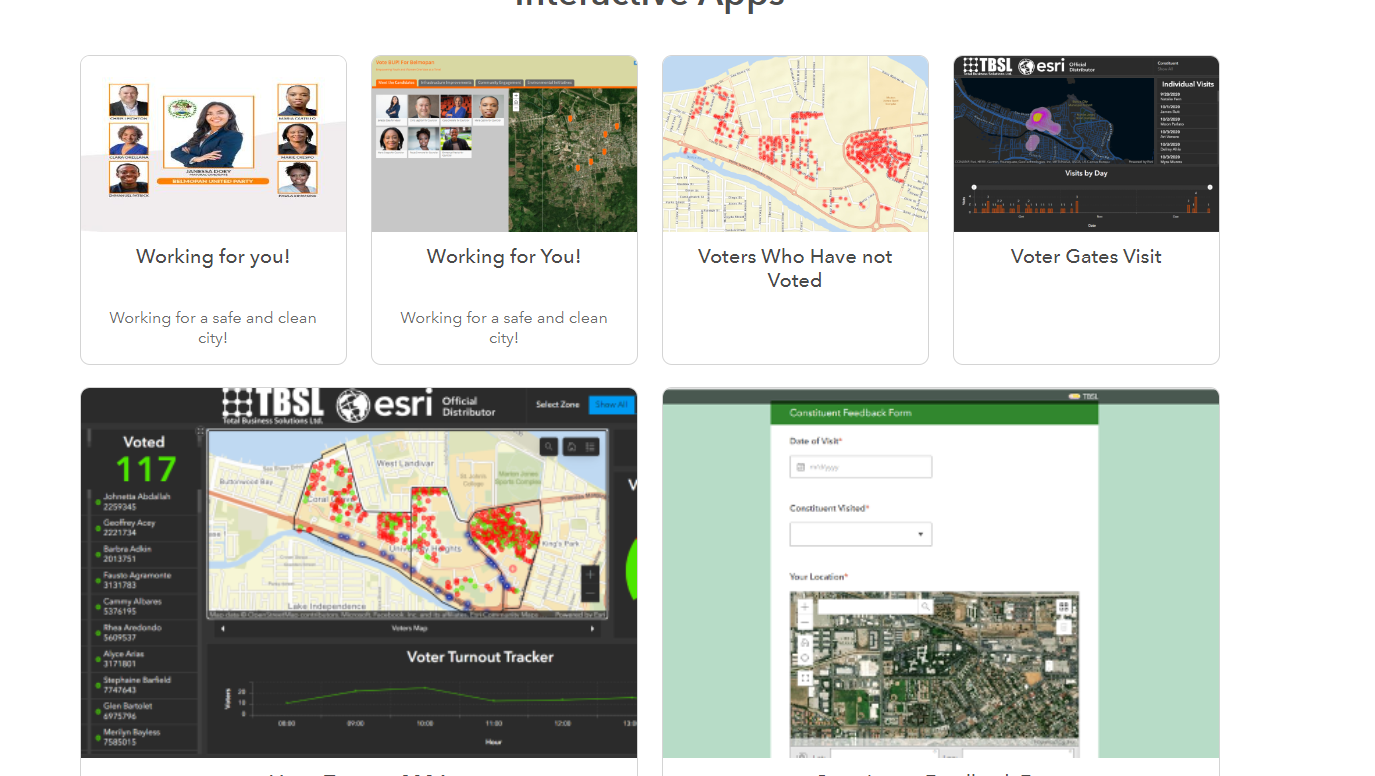

Hello Everyone,
I have 6 apps I want to display on my hub site gallery but every time I publish it keeps looking like 4 small cards at the top and two big cards at the bottom.
How do I get it to display it as 3 small cards at the top and 3 small cards at the bottom?
KlaraSchmitt
Hello @AndrewCastilloTBSL,
Hub uses the 12 column grid from Bootstrap 3, so the the top row of cards is distributed evenly across 12 columns by making each card 3-columns wide. With our Gallery Card, you can have a max of 4 cards per row. So in the second row, where you only have 2 cards, they are being stretched to 6-columns wide. If you want to have 3 cards in the top row and 3 cards in the bottom row, I'd recommend adding a 1-column spacer to the left side of the Gallery. (You will need to downsize it to 1-column.) But that will prevent the Gallery Card from trying to put 4 cards in the top row.

I see, thank you that helps.
