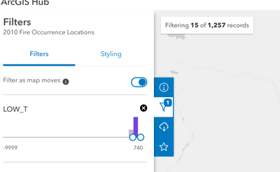

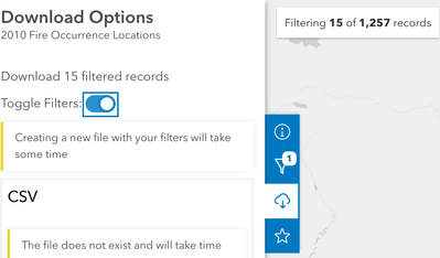

@VCGIvanBrownI'm sorry to hear that you're having this problem. Can you share a link to a problematic example? Also, just to confirm, are you applying a filter (attribute or map) and then enabling the download filter? Below are screenshots where the two toggles are enabled.
toggling both a map-based filter and an attribute-based filter

toggling a download filter to use map-based filter and an attribute-based filter
Screen Shot 2021-06-30 at 6.02.27 PM.pngScreen Shot 2021-06-30 at 6.02.27 PM.png

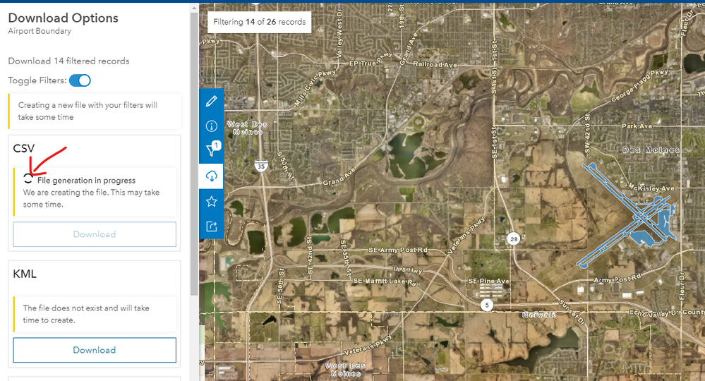

After applying the filter and selecting the file type to download the tool just spins for over 10 min without doing anything.download error.pngdownload error.png
Without the filter data can be downloaded in every format except "File Geodatabase". I'm getting a "File generation failed" error for that one.

@AliciaShyuthere are a number of reasons that a download could fail or take longer than expected to generate. Are you the content owner? Would you be able to provide a link to the dataset?
AliciaShyu
The organization owns the content and it has been shared to the public. Here's the link to the dataset from our Hub site https://data-desmoines.hub.arcgis.com/datasets/airport-boundary/explore?location=41.641450%2C-93.638...
ThomasHervey1
Esri Alum
Thanks for the details. After running createReplica on the underlying service (which ArcGIS Hub uses for executing downloads), it appears that there's an issue and jobs are failing. This may be due to a server-side configuration but you've found a case where ArcGIS Hub should supply better error messaging. I have added this to the backlog. I suggest that you reach out to Esri Support so that they can walk through the download process and troubleshoot.

I wasn't seeing the Toggle Filters slider under Download Options; it has to be slid to on in order for the filter to be applied to the download. Others weren't seeing it either; finally, someone noticed it and pointed it out. It's there; however, there is something about the page layout that causes it to be missed.
