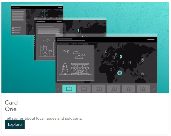

Good afternoon,
I am running into a problem where I set a fixed height for a number of cards displayed in a row (to accommodate different text block lengths or headings that run over two lines), but the button doesn't shift downwards with the bottom edge of the card when its length is changed.

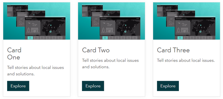

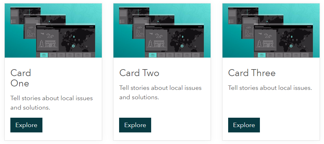

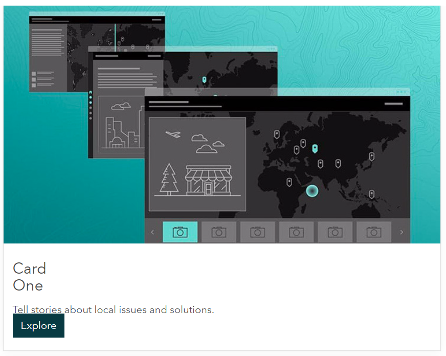

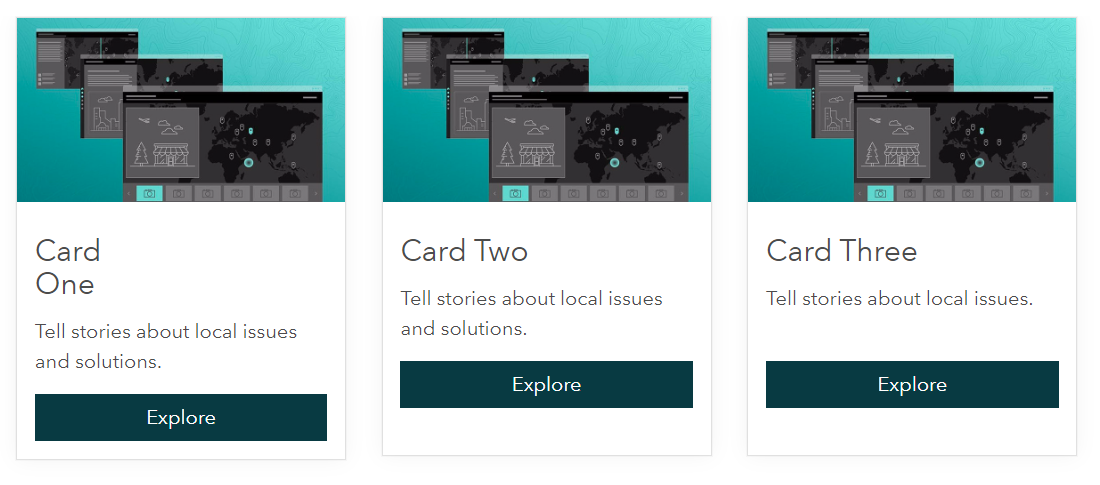

I can get the button to sit at the bottom of the card by modifying the card and button elements via CSS properties, but this interferes with the button itself (changing its width and aligning it to the cards left edge), and the button will either overlap or abut the card text when the viewport is collapsed.
This isn't great, and I was hoping there is a method for shifting the button to the bottom of the card without having to fix it in place - an option to keep the button position responsive, so it automatically adjusts/flows with the rest of the card content when the card is resized.
Ideally (if at all possible), the button position would adjust to the bottom of the card dynamically whenever the card height value is changed (which may be often depending on updated card content length).
The HTML I'm using when trying to get this to work is attached for reference.
Hopefully someone's run into this problem before or is able to shed some light - any assistance would be greatly appreciated.
Kind regards,
Shaun
