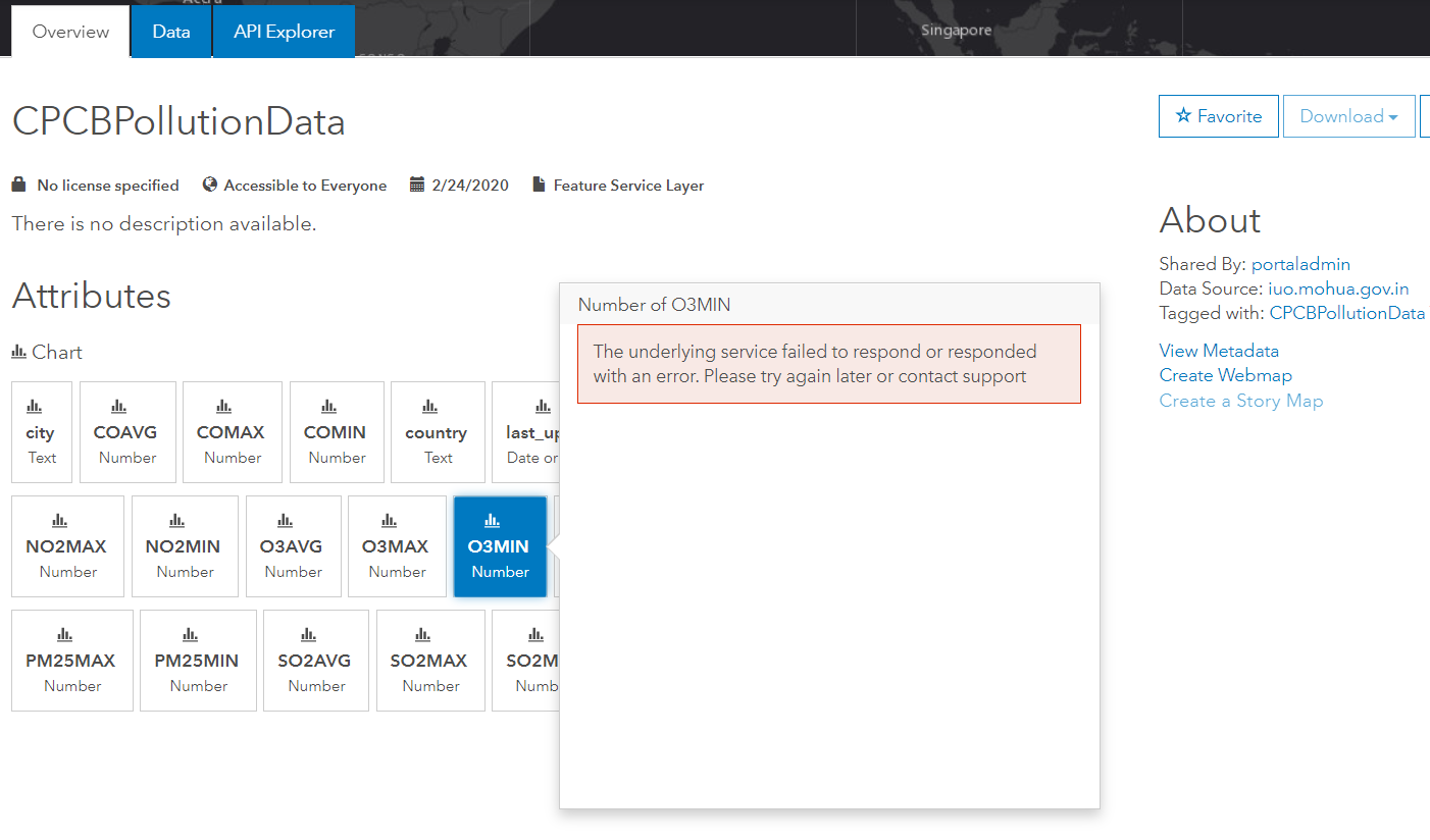

Hi All,
I'm using Enterprise sites 10.7.1

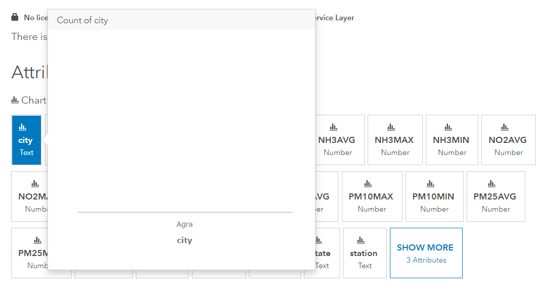

When I click on any of the attribute, I'm getting below error instead of Chart. Also my download option is disabled. I'm using Feature Service and Shared to everyone if I have to change anything.
Even, if there are one unique value, instead of showing some graph, it shows empty chart. Is it expected behaviour.?

Ok, I managed to have the download option available but the statistics are still failing to load:
(same error for all attributes)
