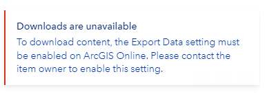

SupriyaK
I'd also like an update on this. The help documentation states that if Export data is disabled on the service, then it wouldn't allow downloads. For some of our services with that setting this seems to work as expected and the download in Hub gives the message below. But for others it still allows download even though Export data is disabled.
