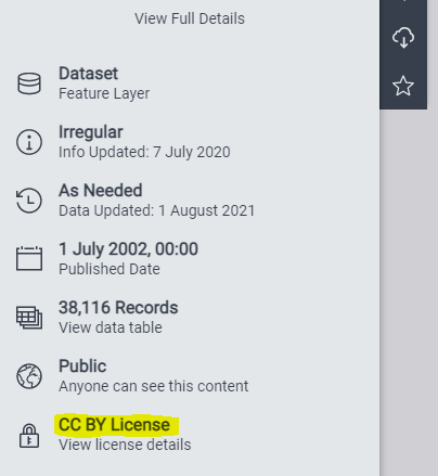

At some point the license terms for our data.json response has changed to the following value for all datasets/apps/web maps:
"license":"No license provided. Request permission to use."
Where is this license value coming from? We've got the following  appearing in Open Data:

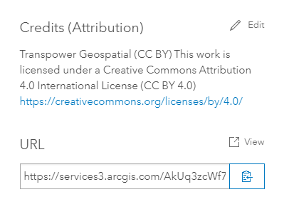

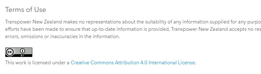

In ArcGIS Online the item has the following Credits and Terms of Use set:
