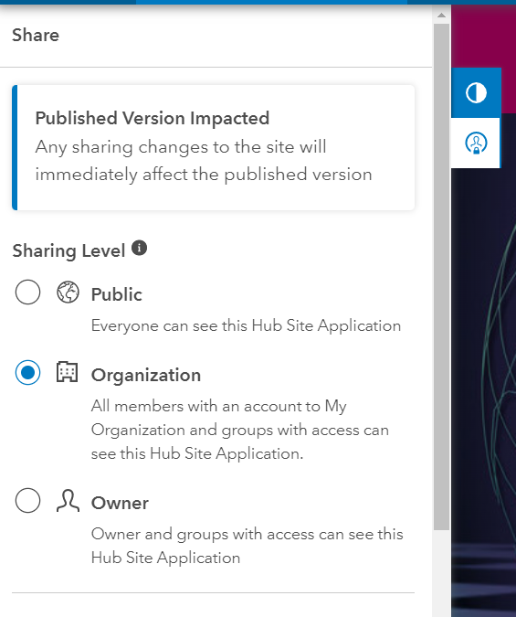

Sites do not have to be shared publicly in order to be cloneable. While you do have to publish the current site draft in order to clone a site, publishing the draft on its own does not make the site publicly available.
Visibility of the site itself is controlled by the Share settings panel in the site editor:
If you don't want the site or any of its clones to be publicly available while it's being worked on, set the sharing settings the to Organization or Owner level. Note that any folks you want to review the site while its set to either of those sharing levels will need an account to your ArcGIS Online organization in order to access the site.

Sydney, thank you for clarifying. I just tried this and it works exactly like you said. Much appreciated.
