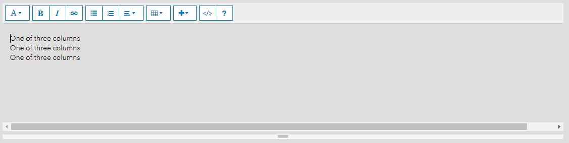

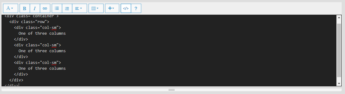

I'm attempting to utilize Bootstrap's Grid System to evenly distribute my Buttons in Columns at the top of my Hub Site.  However, when I utilize their code:
I do not get the same results:
The container does not seem to be generating the row that the columns should be in.  Please help, Thank You!
KlaraSchmitt
Hello Dave,
You should give the column class a number. If you want three columns of even width, it would be `col-sm-4` as Bootstrap 3 uses a 12-column grid system. So three divs, 4 columns wide. Also, you shouldn't need the container or row classes as our Text Card already sits inside a container and row.

DaveSchaab
This worked, thank you!
