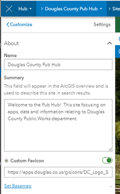

Good morning, I am having an issue with a shared org hub site not displaying the name of the Hub or the summary.  It shows the default language from ArcGIS Hub.  Although my logo does show.  Have a solution?
Thanks
santamariaa
@JulesBarrett Did you ever figure this out? We are experiencing the same issue and wanted to know if this was resolved?
AnastasiaK_OPS
Hi! Not sure if it would solve it for your org, but might be worth checking the Metadata on the AGOL item (the "‎Hub Site Application" item for your Hub site) and confirming that the all the relevant fields are up to date. For whatever reason for our site the Title in the metadata was the did not get updated and that was causing issues in a few places.
