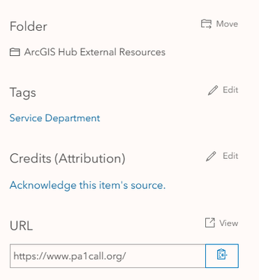

Same issue here, almost three years later.  I have a number of items tagged as "Service Department" with the idea that they would only show on a department-specific hub page:

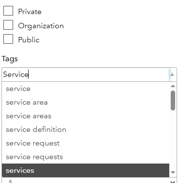

However the gallery configuration doesn't seem to think this tag exists in my org:
** edited to add - I tried what was recommended above and it looks like a tag that is one phrase and all lowercase (servicedepartment) does work.
