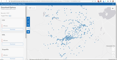

I am also hitting this issue on personal use account (which means I cannot call Esri Support).
@ThomasHervey1  I tried the following with no luck...
1) Recreated  the gallery
2) Update the Hub site settings to allow for local projection
Here is my site if you want to test it out https://data-pjdohertymaps.opendata.arcgis.com/
Here is the dataset I am trying to make available via Open Data
