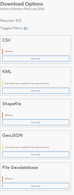

We started noticing this on three of our recently published feature services. This is what we see on our Historic Election Precincts 2004.

Hi @JosephBisig
We understand that the "API Error" is generic and can be confusing. Have you enabled the "Local Projections" setting on the Hub site? Hub needs a numeric SRID and will throw an error when trying to query metadata without one. For example, on this item on Hub https://gisdata-piercecowa.opendata.arcgis.com/datasets/pierce-county-council-districts/explore the Hub API returns an error when trying to get metadata. On that item's service
the Spatial Reference is
      PROJCS["NAD_1983_HARN_StatePlane_Washington_South_FIPS_4602_Feet",GEOGCS["GCS_North_American_1983_HARN",DATUM["D_North_American_1983_HARN",SPHEROID["GRS_1980",6378137.0,298.257222101]],PRIMEM["Greenwich",0.0],UNIT["Degree",0.0174532925199433]],PROJECTION["Lambert_Conformal_Conic"],PARAMETER["False_Easting",1640416.666666667],PARAMETER["False_Northing",0.0],PARAMETER["Central_Meridian",-120.5],PARAMETER["Standard_Parallel_1",45.83333333333334],PARAMETER["Standard_Parallel_2",47.33333333333334],PARAMETER["Latitude_Of_Origin",45.33333333333334],UNIT["Foot_US",0.3048006096012192]],VERTCS["NAVD_1988",VDATUM["North_American_Vertical_Datum_1988"],PARAMETER["Vertical_Shift",0.0],PARAMETER["Direction",1.0],UNIT["Foot_US",0.3048006096012192]]
I believe that you'll either need to make an adjustment to the service's spatial reference or disable local projections, which will serve results in EPSG 4326.

Hi Thomas!
These items now work on our Hub site. It did look like a projection issue that was solved by reloading the data into our map projects and republishing. Always appreciate the help Thomas!
