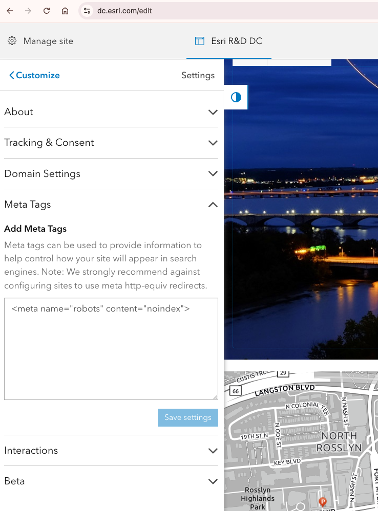

Thank you for this suggestion. You can do this now in Hub through a different method using Meta tags.
In the Site layout editor, in the sidebar for 'Settings', click on 'Meta Tags'.
Then add this tag
<meta name="robots" content="noindex">
Save and publish the layout. When search engines crawl the page, this tag will be added to the HTML and the site will be blocked from the indexers.
You can see an example like on our Team's hub site https://dc.esri.com
