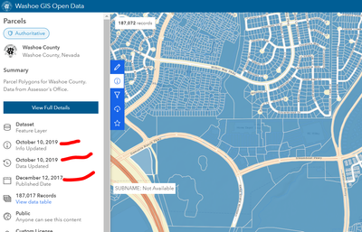

JayJohnsonWashoeCounty
Yes, yes, yes.  None of the dates shown in Open Data are useful to the general public.  They are misleading and confusing.  Datasets that are continually edited (like parcels) and which are never more than 24 hours behind (AGOL cache refresh) appear to the casual user to be years old.
PLEASE give us control over whether these fields are shown in Open Data.

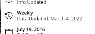

StefanieWenker

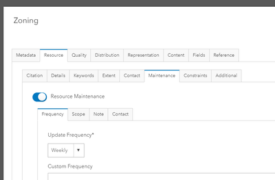

As an FYI - I found a way to change the last updated date to a frequency:
To do this - go to the item details page and click on the metadata button. Then go to resource, maintenance and set the frequency. I am curious to see what will happen a week from now, but at least it is something 😉
by Anonymous User
@StefanieWenkerDid this workaround work for you? Does the "Data Updated" date change automatically to reflect the schedule you set?
City_of_KelownaGIS
No it didn't, but at least it still says weekly???
