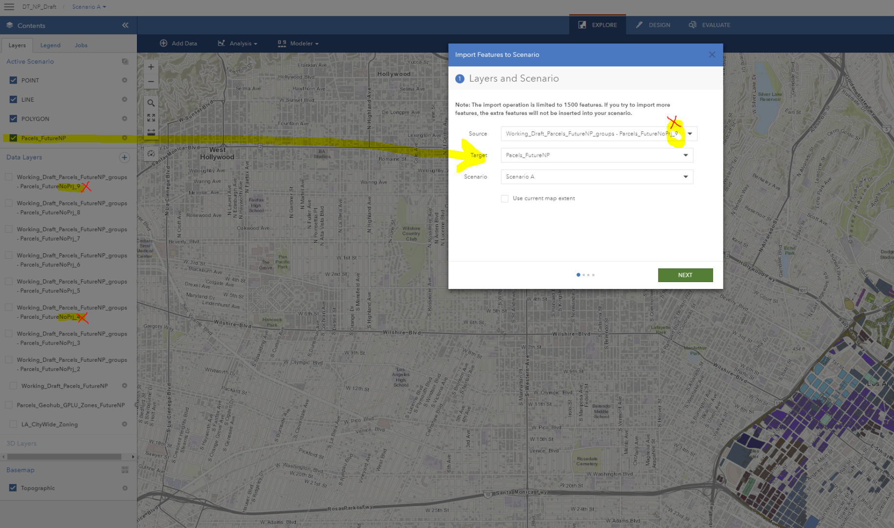

I am setting up an Active Scenario in GeoPlanner and have imported several feature layers from ArcGIS Server (Portal).  Since the import limit is 1500 records, I created groups from my feature layer and have them broken out into 9 data layers.  My problem is 2 of the 9 feature layers failed during import (group 4 and 9).  I can see no clear reason why these two would fail but not any others.  Any help or ideas would be greatly appreciated.  I have attached an image to help explain the problem.

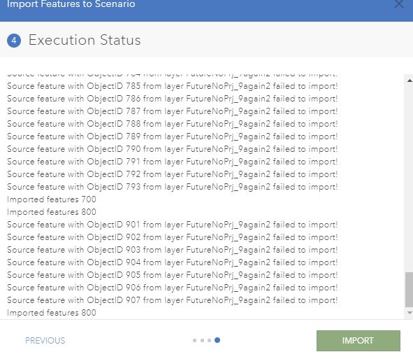

JacquiSwartz1
Hi Kenneth,
Thank for your help.  I was finally able to jump back onto this.  Interestingly enough the import for Group 4 was successful but Group 9 failed.  See image below.  Only 800 of my 934 records imported.  Any thoughts?
