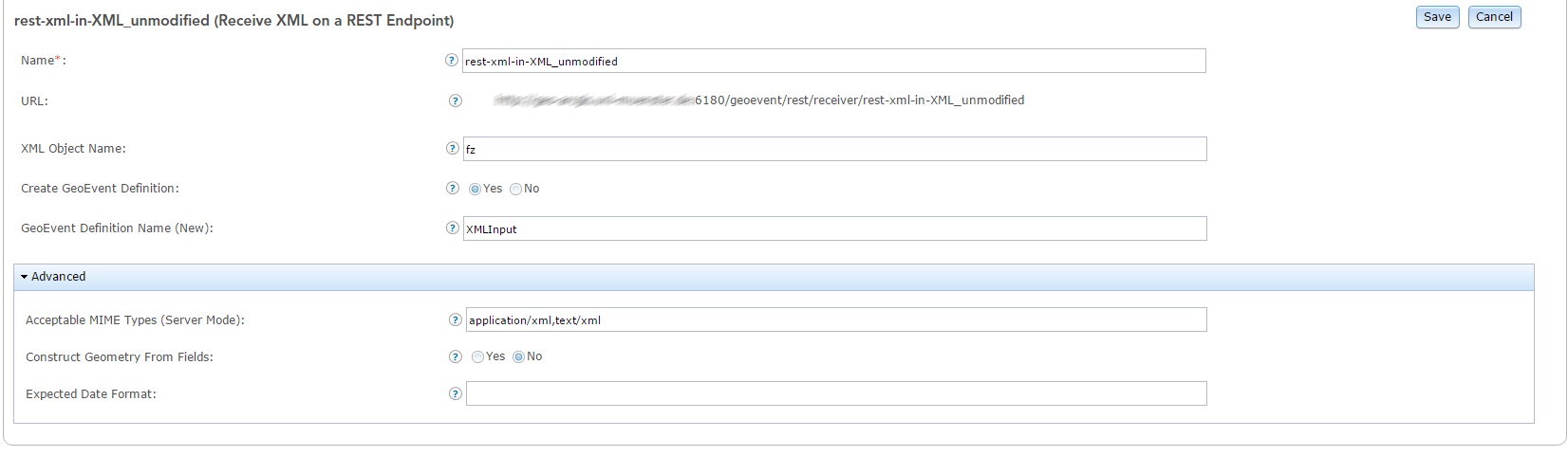

For tesing purposes I have configured a "Receive XML on a REST Endpoint" input adapter. Later on I will poll an external website for the XML data...
The adapter is configured as the following:

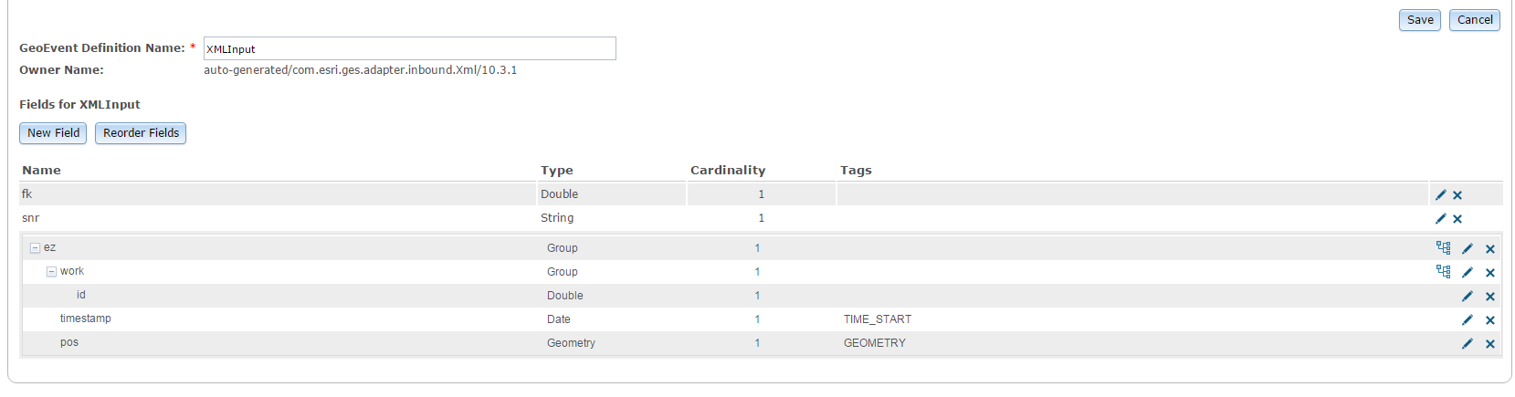

The genereated GeoEvent Defition is generated as the following. The position field is correctly identified as the GEOMETRY-Field, so I assume that I do not need to construct the Geometry-Field manually!?
