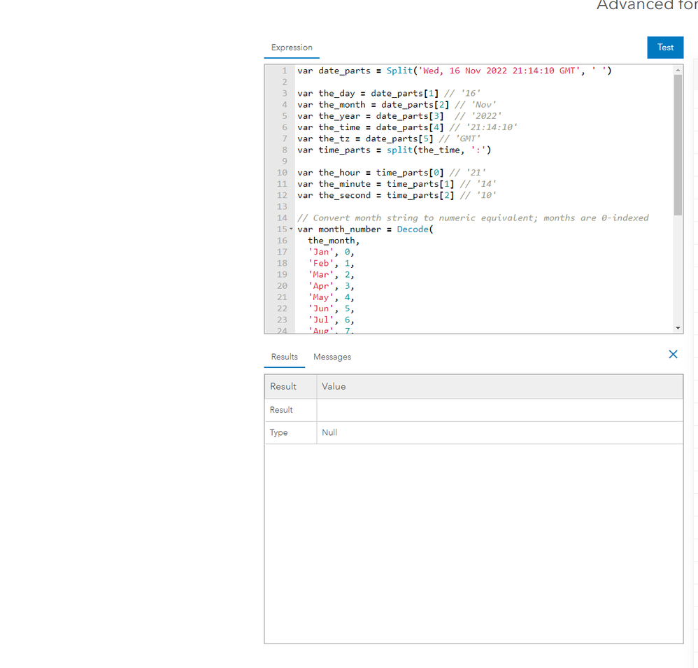

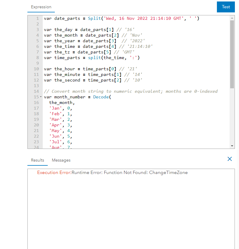

ThomasRickett
We have been trying to get this to work but we are running into 2 errors. We are getting back a null field value when we test it in our dashboard. Either I don't understand how to return things, or I don't know where to put in the field I want to change which is (bcs_Response_Date) . Also, I don't have the function to Change Time Zone.
ThomasRickett
Invalid FunctionInvalid Function
