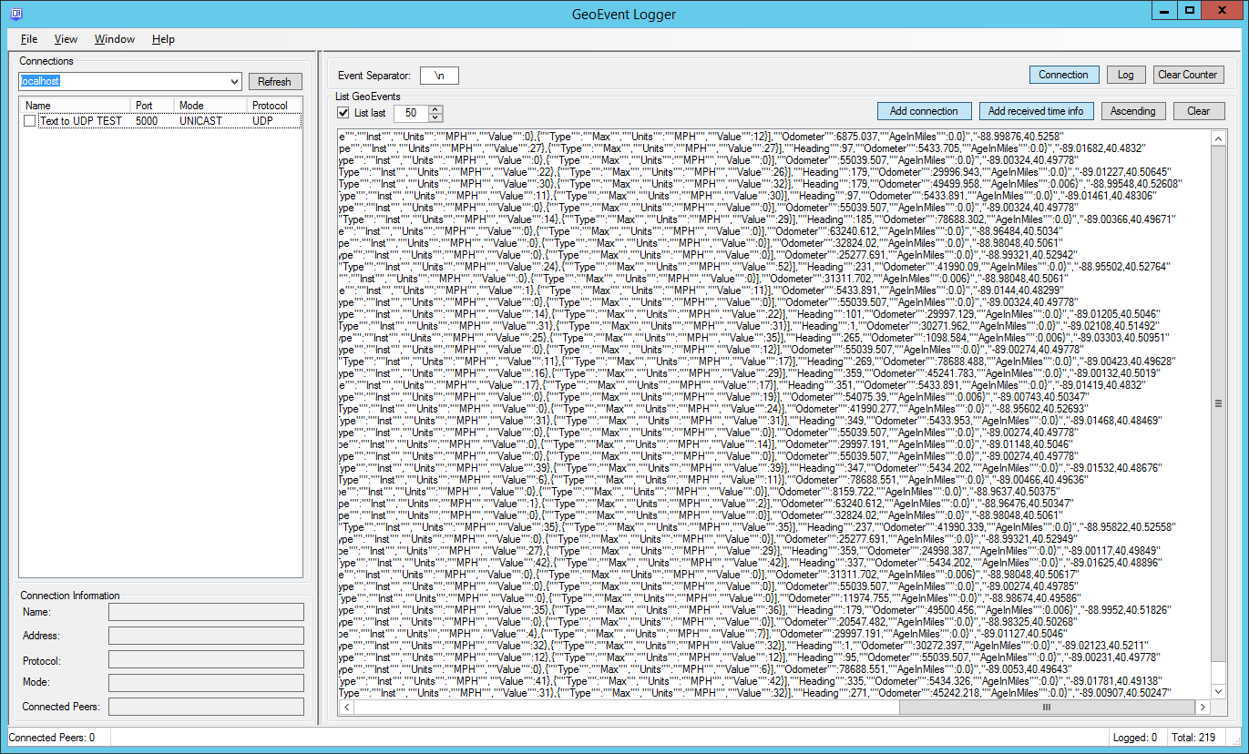

I started looking at the data in Logger and it appears that the data coming from Verizon is not consistent but I think some of it should be passing through Geoevent.  I will attach a screenshot, but when you look at the data, some of the events are missing the Heading field.  Could this be causing the schema problem?  I would think the ones in the correct order would make it through to the service?

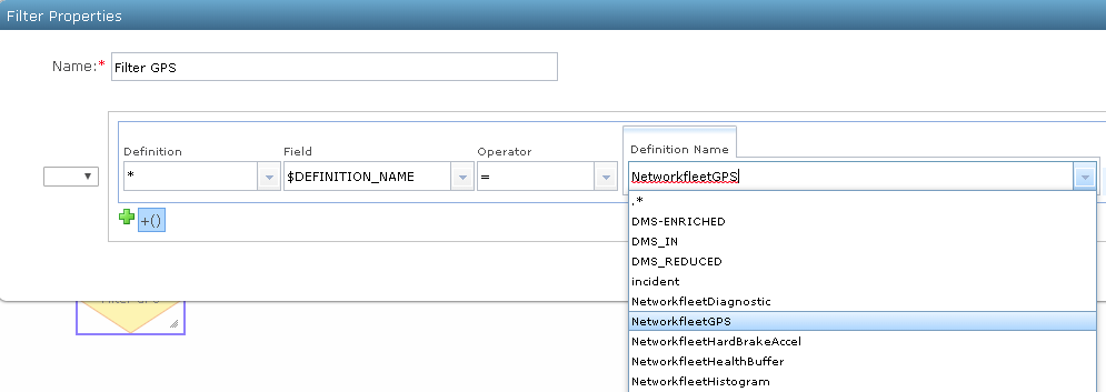

Page 6 in the documentation lists the different message schema you might expect to receive from Networkfleet. In most cases people only get the NetworkfleetGPS messages (but some people get all of them).
Verizon Networkfleet Message Types
You can put a filter between your input and your output (stream service or logger) to filter for only the GPS messages.  That will ensure you only pass the GPS messages through.
