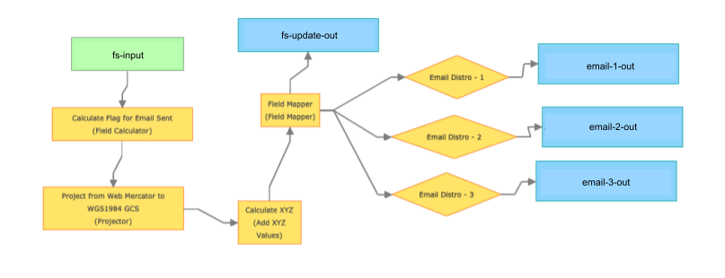

Here is the desired workflow:
Based on the documentation, https://enterprise.arcgis.com/en/geoevent/latest/analyze/attribute-filters.htm, what we have set up should work, but since the documentation doesn't go back to 10.7, I'm wondering if there might be something I'm missing.

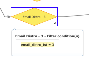

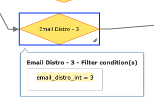

I tried many combinations of things, but always ended up with the filter as a block:
  • Field as a string field, tried the filter with quotes and no quotes around the text, as well as trying the field value and alias values.
  • Field as integer field, using the integer field values
  • I also tried using "=" and "MATCHES", with the resulting value as a regular expression.
