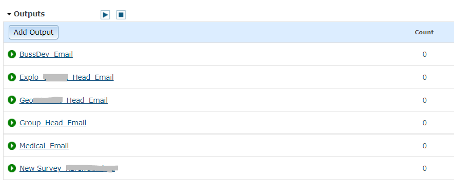

  • Created individual Output for each Status.

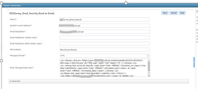

2. Configured Outputs for each Status with different sets of email recipients.

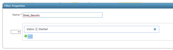

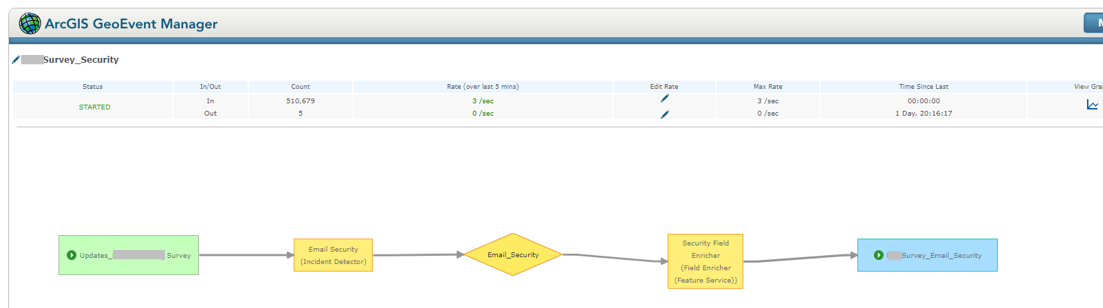

3. Created individual GeoEvent Service for each Status with Incident Detector and Field Enricher Processors and Filter. The following screenshots is based on the ‘Security’ Status. (see GeoEvent Service_Security Status screenshot).

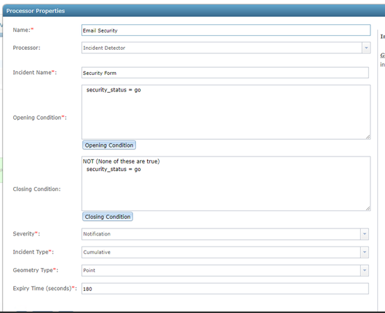

  • Added the Input for survey updates and connect it to an Incident Detector Processor. We configured Opening Condition when the Security Status is Go while the Closing Condition is the opposite of the Opening Condition.
  • Configured a Filter after the Incident Detector Processor.

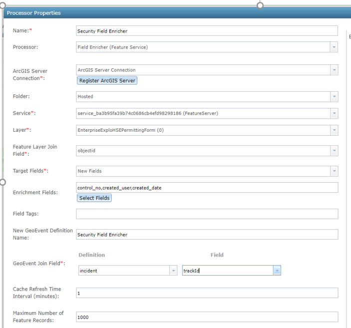

  • Afterward, configured a Field Enricher Processor connected to the Filter. (see Field Enricher screenshot)
  • And then finally, added the appropriate Output for the Security Status.
