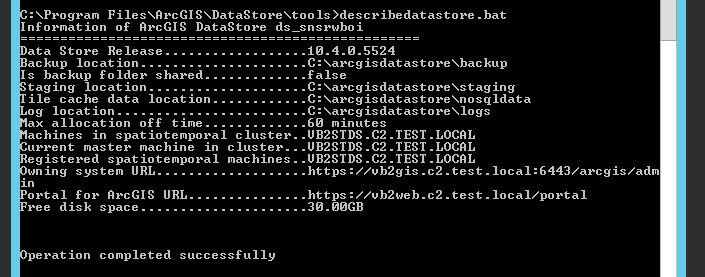

Here is the description from the describedatastore command:

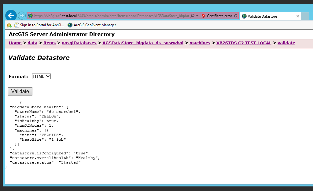

and here is the Data store validation from the Server manager:

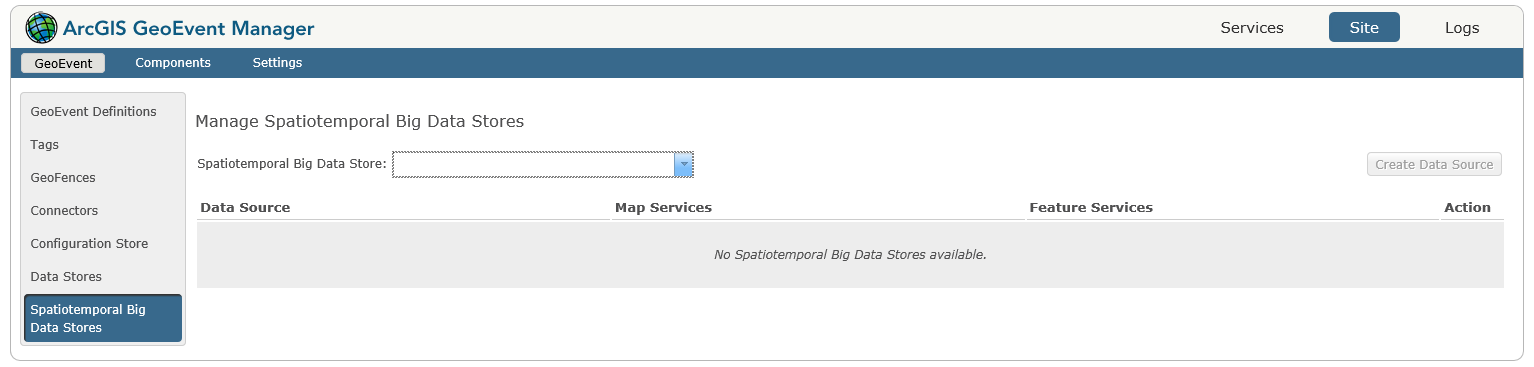

So everything looks good, but the Data store is not showing up in Geoevent manager:
I added it to server using the server primary site administrator account before I federated with portal.  I also have a regular data store running on another machine that has been added to portal as the hosting server.  All firewalls are turned off.

Did you try stopping the 'ArcGIS Data Store' service running on the, I'm assuming, Windows machine on which you installed and then enabled the spatiotemporal big data store (vb2stds.c2.test.local)?  In an internal staff training today, a couple of folks were seeing an error logged in GeoEvent ("com.esri.ges.datastore.bds.internal.BDSClientImpl  /  None of the configured ArcGIS Spatiotemporal Big Data Store nodes are available") when trying to create a new output to add features to their BDS.  Restarting the ArcGIS Data Store service fixed their issue.
If you try to browse to http:// vb2stds.c2.test.local:9220 does Elasicsearch respond by asking you to authenticate (provide a username and password) to log-in?  You don't want to connect to Elasticsearch directly over port 9220, but trying to do so might tell you wether or not the service is responding to requests.
Were you able to register and validate a "Portal" type of server connection with GeoEvent as a Data Store?  If GeoEvent does not have a registered server with a recognized BDS the 'ArcGIS Server Connection' dropdown will be empty when trying to configure a GeoEvent output to either add or update features in the spatiotemporal big data store.

did you also register the Big Data Store in the Data Stores tab in GeoEvent Manager?
I had setup GeoEvent and Data Store with Portal and Server on my laptop and with some useful info from RJ I enabled the spatiotemporal big data store using that same command line. then registered the new datastore (as a portal store) in GeoEvent Manager. voila!
