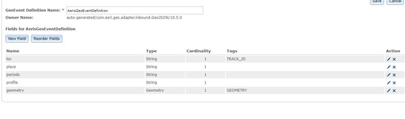

Here are the fields that got created the first time that we sent a post to the endpoint:
Unfortunately, only Geometry actually gets populated with data when a post is sent. The data is the lat and long, in quotes, separated by commas. None of the other fields shown above show any data. Do we need to define fields manually (using the "New Field" button in the screen capture above), perhaps whatever of the subfields in the geoJSON we want, e.g., tempF in the periods array? I'm now also noticing the Tags column in the above, but don't know what they mean.

My guess is that GIS Server doesn't know how to handle your properties because they are not simple data types, i.e., string, integer, double, etc....  For example, how do you expect the following to get stored in a table?

Thanks for the reply. I'm not sure how the server handles the GeoJSON it receives, and I think that's part of the problem. The initial post request caused the fields in the screenshot of the GeoEvent definition to be created. I suppose my expectation would be that there'd be server-side code to traverse the JSON and pull out the individual key-value pairs, though that still leaves the question of how it would represent the hierarchy in the structure, e.g., if "name" is a column heading in the csv file and "minneapolis" a value in that column, where does "place" go?
My question now is, do I have to modify the GeoJSON to flatten it out, or specify the fields I want in the GeoEvent definition differently to get what I want, or will either, both, or neither be required to achieve what I want? There's example GeoJSON in the page to which I linked, but it's a lot simpler than what I'm sending. Are there other examples I can look at that you're aware of? I was able to stick arbitrary key-value pairs in a "properties" section of GeoJSON and have those get populated in the generated csv (after a new GeoEvent definition was generated with the first post request with the new GeoJSON), so I know that works, but again, I'd prefer not to have to do a lot of reconstructing or reformatting of the GeoJSON, unless it's necessary.
I think you just answered your original question.  Posting GeoJSON to a REST endpoint won't flatten nested JSON, and ArcGIS Server appears to have no means of storing the JSON as an object type, although I doubt you would want that anyways.
