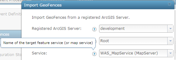

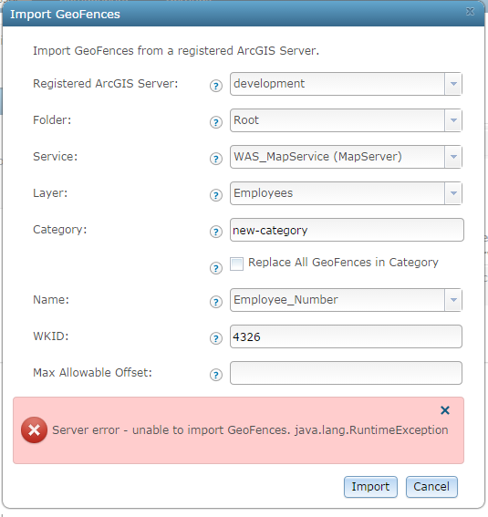

I am unable to import a GeoFence from a Map Service in GEP 10.2.2
I have tried restarting GEP and ArcServer several times, I keep getting the same error.  Below is the output found in the Log for this error:
com.esri.ges.rest.service.interceptor.RuntimeExceptionMapper
Caught exception with no message. java.lang.RuntimeException at com.esri.ges.rest.datastore.internal.DataStoresRestServiceImpl.registerGeofence(DataStoresRestServiceImpl.java:266) at sun.reflect.NativeMethodAccessorImpl.invoke0(Native Method)[:1.7.0_51] at sun.reflect.NativeMethodAccessorImpl.invoke(Unknown Source)[:1.7.0_51] at sun.reflect.DelegatingMethodAccessorImpl.invoke(Unknown Source)[:1.7.0_51] at java.lang.reflect.Method.invoke(Unknown Source)[:1.7.0_51] at ...

Hi Katie,
Thank you for providing access to your data that you are using to publish this map service.  It appears that the issue is due to Null geometry in some of the features in the Employees Layer.  Try editing the feature layer to remove the addresses that scored "0" and republish the map service.  Let me know if you then have any issues with using it as a geofence.  Best Wishes,  Carrie
