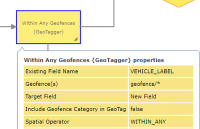

I'm having an issue with a GeoTagger not tagging a point event feature WITHIN_ANY geofence polygon on a 10.7.1 instance.
I have created the geofence polygon such that if the inbound event point feature is not within one of the Allowed areas, it will be tagged with the inverse larger area geofence called None. A GeoTag value should always be applied to the point event features, though this does not appear to be consistently working near the western and eastern extremities of the largest geofence. The inverse None geofence is also not being tagged, which is the most surprising part.
