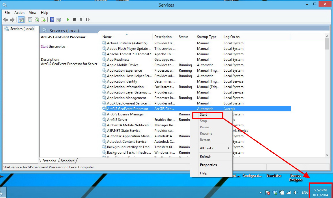

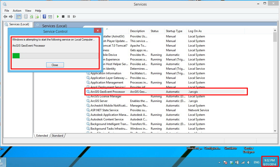

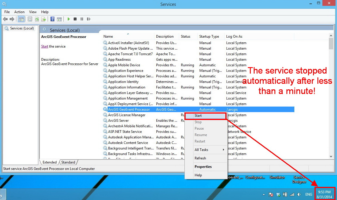

Hello all,
I've installed ArcGIS 10.2 Geoevent Processor for Server, after the setup completed I started the Geoevent Service (and it is set to automatically start on startup), but the service stops automatically after less than a minute, I started it many times and each time it fails to continue running. What might be the problem here? This is shown by screenshots
Any help is appreciated,
Hani

Hi Hani,
Have you tried to look at the logs files of geoevent processor, located in ArcGIS\Server\GeoEventProcessor\data\log ?
there are Wrapper logs (service), and application server logs,
there might be records informing about the issue encoutered.

HaniDraidi
Hello Rainer,
Thank you very much, I referred to wrapper.log and it seems that their is a problem with the license.
