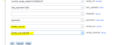

I can give you an example of what mine looks like. Here is a snip from my JSON feed. You can see that the rental uris property is multi-cardinal with a link for iOS and Android.
So... in the mapper it looks like this when trying to specify that I want to map the iOS link to the rental_ios feild in my feature service, as well as the android link.

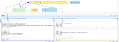

Here is how my data is leaving the field mapper currently:
  "GED_Name": "Risk-IN",
  "identifier": "43311",
  "sent": "Mon Apr 01 13:40:24 EDT 2024",
  "status": "Actual",
  "msgType": "Alert",
  "category": "null",
  "headline": "<p>A bunch of info html coded text for details</p><p>Rain Threat:<br/>&nbsp;&nbsp;&nbsp;&nbsp;Range, 2-4 in<br/>&nbsp;&nbsp;&nbsp;&nbsp;&nbsp;&nbsp;&nbsp;&nbsp;Impacts: High water, Washouts, Road closures, River flooding</p>",
  "description": "Another really long block of text",
  "scope": "null",
  "language": "null",
  "event": "Early-Week Severe Weather for the Central U.S. - Rain 1",
  "urgency": "null",
  "severity": "null",
  "certainty": "null",
  "effective": "Sun Mar 31 19:00:00 EDT 2024",
  "expires": "Wed Apr 03 07:00:00 EDT 2024",
  "web": "null",
  "resourceDesc": "null",
  "uri": "null",
  "areaDesc": "Early-Week Severe Weather for the Central U.S.",
  "polygon": {
    "rings": [
          -76.96959699999996,
          39.28723100000008
          Removing to make this easier to read   ]
    "spatialReference": {
      "wkid": 4326
  "area": "null"
 I want Category to be this since it is multi cardinal
  "status": "Actual",
  "msgType": "Alert",
  "category": ["Weather"],
  "scope": "null",
  "language": "null",
  "urgency": "null",
  "severity": "null",
  "web": "null",
  "uri": "null",
  "polygon": {
    "rings": [
          -76.96959699999996,
          39.28723100000008
      "wkid": 4326
  "area": "null"

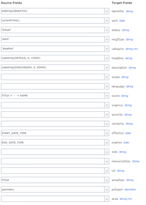

 I am unsure how in field mapper what syntax is needed to get it at an array:
Gene_Sipes
Without seeing your entire setup (mappers, calculators, etc) it's hard to tell what you are trying to do. From these two screenshots, your source fields do not match the incoming json feed properties. For example, you show a source field called DISCUSSION that has a substring method called on it. Where does that come from?
SpatialSean
Cutting down from the data in to only show the first 10,000 or 50,000 characters.

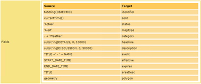

On my Target I have a field category that is a string and multicardinality.  I want to push the word 'Weather' into it but on the field mapper I am unsure what that syntax is.
Currently I have it written as . + 'Weather' on the field mapper which outputs as:
  "category": "null",
 What I want it to result in is:
