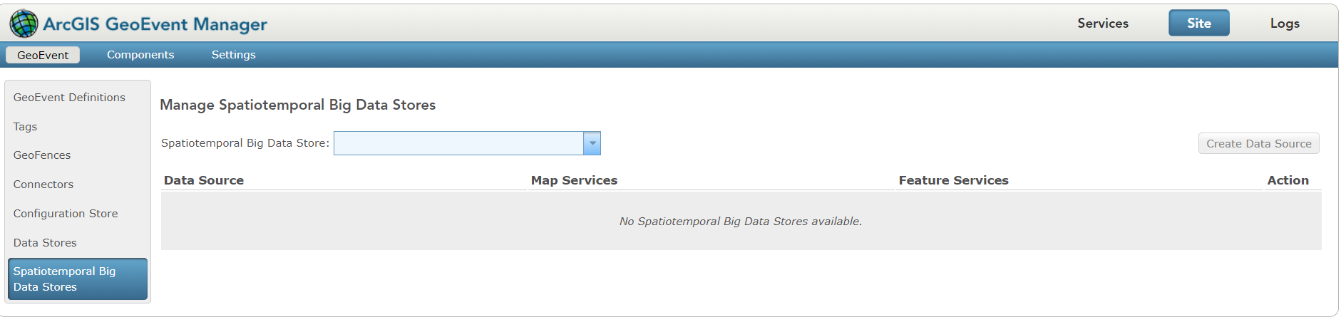

Hi Guru,
I encountered an issue while setup the geoevent server with bigdatastore. Both installed in different server, using the domain user accounts. All installation, configurations are gone through smoothly but only one issue is that I cannot see an option to create a big data store and no connection in drop down.

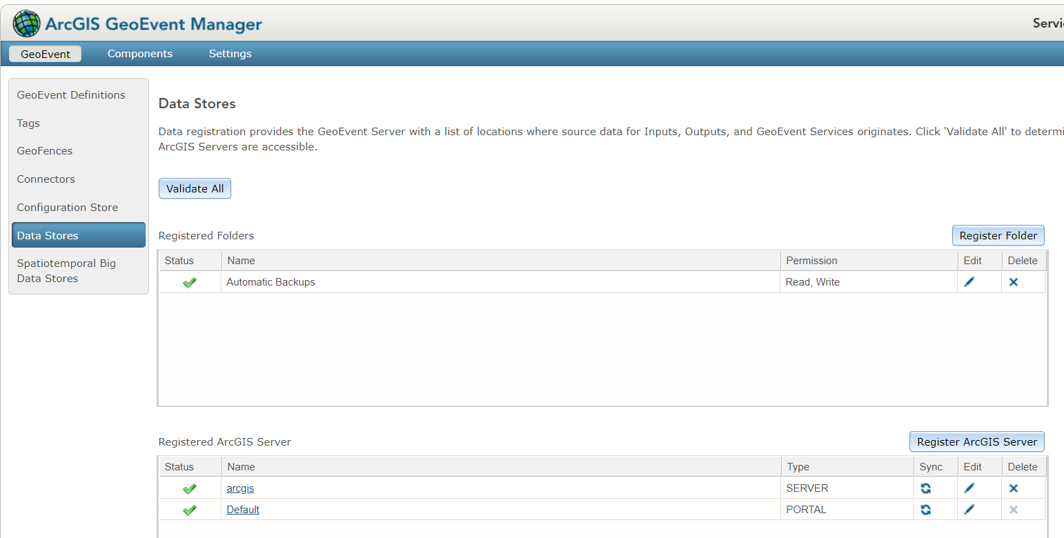

When I look at and validate datastore, the portal is as default connection as well.
When I try to validate through arcgis manager datastore validation, these are valid as well.
But just only one thing I found out is a bunch of log info geoevent, I don't  understand what does this mean.
Can you guy guide me where went wrong, I have attached the log file as well.
Thank in advance,

by Anonymous User
Not applicable
Hi Stefan,
Have figured out that hosting server dropdown need to re-select arcgis server and save in portal setting page.
As there are two settings to configured in servers tag in portal setting page.
It seems, it must be connected all together first.
And additionally, I did replace all ca cert by using replace ssl cert command in all data stored servers.
Best Regards,
Than
