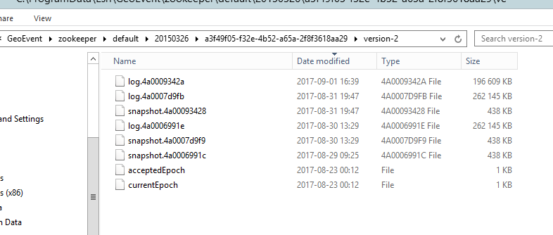

Im running GEE 10.4.1 and Im starting to recieve GEE log WARN messages like these:
org.apache.zookeeper.server.persistence.   FileTxnLog fsync-ing the write ahead log in SyncThread:1 took 1332ms which will adversely effect operation latency. See the ZooKeeper troubleshooting guide.
The ZooKeeper files are getting quite big, and I guess thats the reason for the messages...
ZooKeeper files
Whats a good plan to automate a purge job on these files, keeping them small and GEE happy?!

No I only have 10-15 services published in total, including 2 steam services. Log files are +200 MB...
How configurable is ZK? Edit config files for purge file size, file location etc? Should this be done while GEE windows service is stopped?
