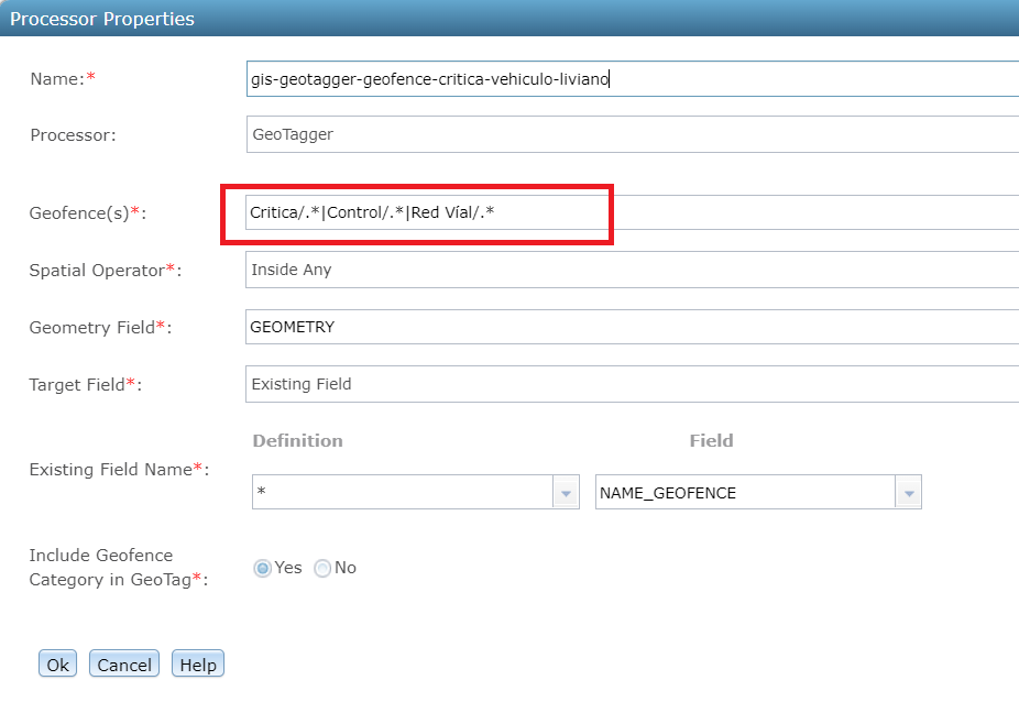

Hi everybody:
I got an issue, i would like to use in GeoEvent, the processor GeoTagger, but in the geofence(s) I would like to use 3 geofences from 4 available.

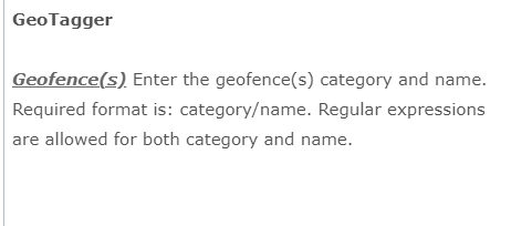

this is the tooltip in the field geofences. Maybe isn´t supported all regex.
I have mark with red the field where the regex it goes.
With the example below, doesn't work.
Have any suggestion?

My understanding is that you cannot do what I am trying to do, the scope of regular expressions in that field are limited to the use of "*" or another character, not a complex expression.
So in my case, I changed the logic, and I had to use a field calculator and a field enricher.

GarrettMelvin
I have been able to include multiple geofence categories in the same geotagger processor.  Try to group your geofence category descriptions before the / and use an OR character in-between each category.  Format like "Category1|Category2|Category3/.*"  I believe based on your category names it would be:
Critica|Control|Red Vial/.*
I am not certain if the space in Red Vial will have any impact.  Hope this helps.
