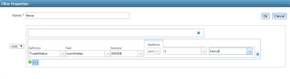

I believe I found the solution, I did the following to get tweets from a particular geofence only.
1. Import the polygon as a geofence on the SITE tab
2.Add the same polygon to the Geoevent Definitions
3.From the Geoevent Services tab add a filter.
That I believe solves the problem.
