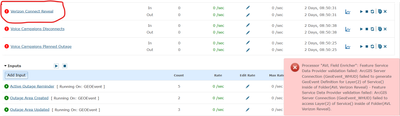

Could use a bit of help. A bit of background, we have a service with Verizon for our vehicles to updated their locations in our workorder management system. Service was working just fine on Friday, now we are not getting any location updates. Upon investigating on GeoEvent Manager, the input service was fine, but found the three output services with error. Restarted these services but still getting the following error for the main service:
I am filling in while we look to replace our GIS Manager that left a couple weeks ago and this issue was not covered it the "I'm leaving" packet! 😂😥 Any help would be greatly appreciated. Thanks in advance!
maverill
Nevermind folks, I was able to get it fixed. Looks like it was an issue with a Field Enricher. Think the settings got jumbled after a server patch was installed. I was able to update the settings and re-publish it. The services restarted without issue once this was completed. Crisis averted.
maverill
Gene_Sipes
Glad you got it. Never underestimate a geo event server restart as well. In my experience I have had issues with Zoo Keeper not starting up even though the rest of the geoevent server services are up and running. A restart fixes it. Good luck!
GarrettMelvin
We have run into a similar issue before, and restarting the windows services resolved the issue without rebooting the server machine.  Stop order-ArcGIS GeoEvent Server, ArcGIS GeoEvent Gateway, ArcGIS Server.  The start back in reverse order.
