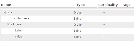

A GeoEvent definition was created after I created an Input connector consuming the JSON.
How do I map this GeoEvent so that I can update to a Feature Class through a feature service with fields: Manufacturers, Name, Year, Weight, Passengers?

Did you try to create a "flat" GeoEventDefinition with the attributes that match your Feature Service and then create a field mapper in the service definition? In the input connector you leave what is automatically generated.
It doesn't look like that your json has a geometry, true? If yes, you need to create one as well in your custom definition (with the type geometry and the tag GEOMETRY).
In my case, there is no geometry, so I created the service with the points in Desktop and added the table and the relationship class (1:M) in the GDB before publishing the service. The GeoEvent Service writes the results into that related table.
Would this be suitable use case for you as well?
