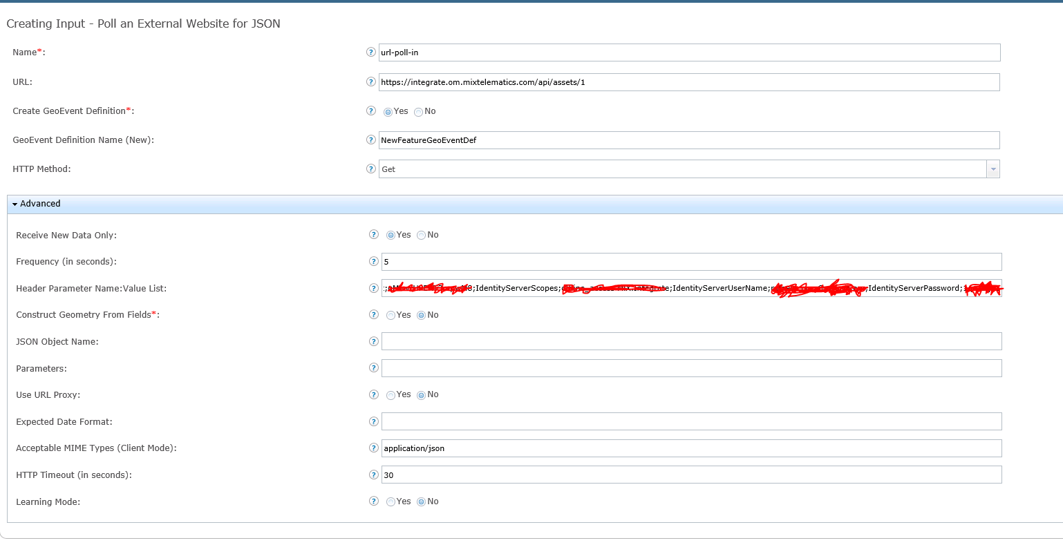

khadijaff
Hi Medina,
thanks for your email.
I have quite good introduction , but I need your help with configuration .
I do have them ( a client id, client secret, base url, and the endpoint for the operation you want to use ) . but its seems its difficult cuz its need access and token .
however I configure it as showing below , would you please advise if its correct ?
the ERROR says : Second attempt failed. Giving up. (https://integrate.om.mixtelematics.com/api/assets/1 --- Connect to integrate.om.mixtelematics.com:443 [integrate.om.mixtelematics.com/185.64.24.232] failed: Connection timed out: connect)
thanks,
KHADIJA
