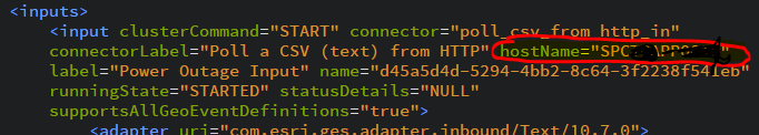

  • "hostName" information - for example, in an input:
    Seems as this just refers to the name of the host where GE is installed.  Will this be overwritten on the new machine?
