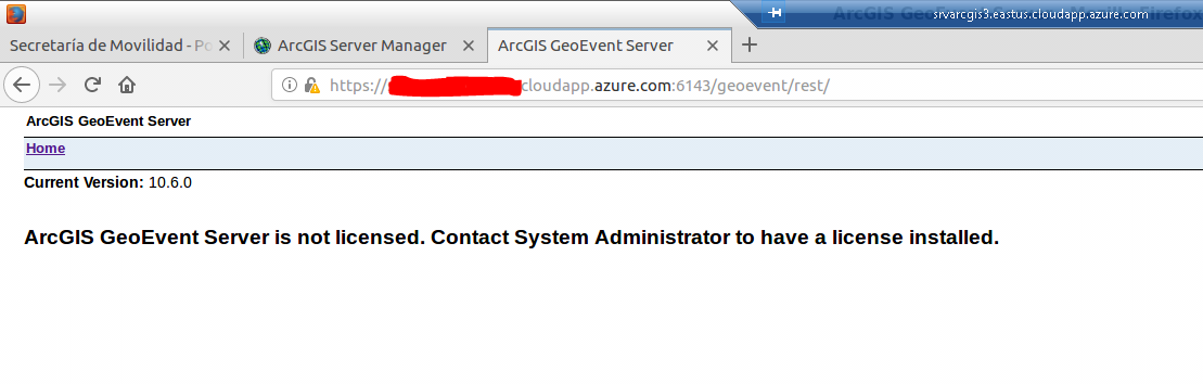

I'm getting this error message whenever I try to access the GeoEvent 10.6 manager site:

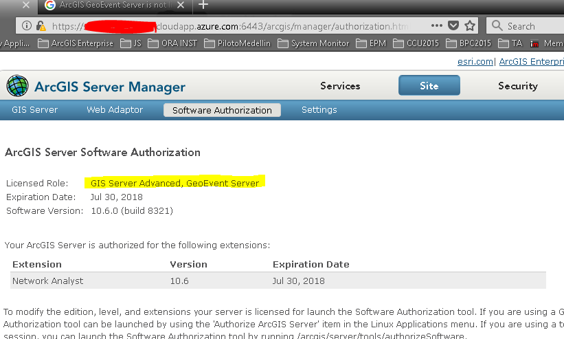

Even though, ArcGIS Server seems to be correctly licensed:
I've re-loaded the ECP file, edited de Keycodes file, restarted services and even the server itself without any Success.

Did you ever find a solution Sergio Eduardo Galindo ? I have the same issue in 10.5.1
