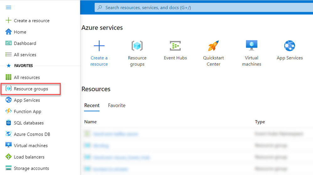

As seen in Figure 1 below, on the homepage of the Azure portal, click on the menu button on the top left corner and click on the Resource groups among the list of available items

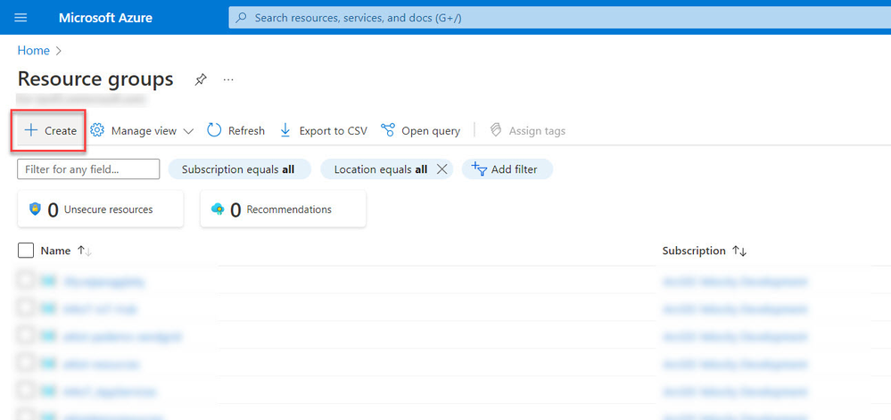

On the Resource groups page, click on the Create button on the top left corner as shown below in Figure 2.
YujingWu_1-1669641401726.pngFigure 2. Resource groups page

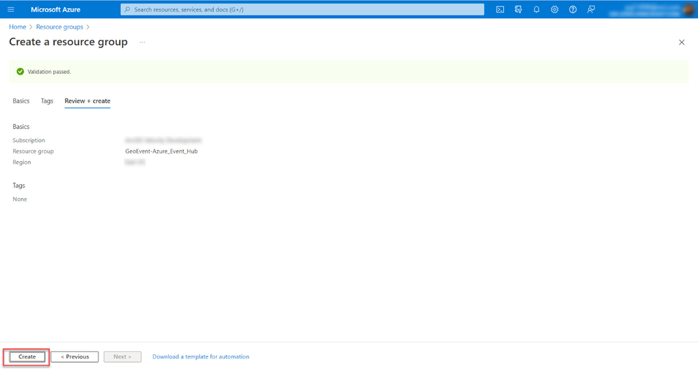

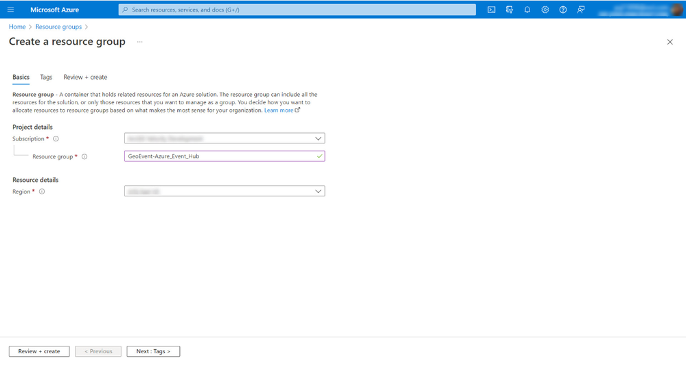

Fill out the form to create a new resource group. Select the subscription under which the resource group will be created. Give a name to your resource group and select an Azure location. After the form has been validated, you will be directed to the page shown in Figure 4 below. Click on the Create button on the bottom left corner to create the resource group.
YujingWu_2-1669641401731.pngFigure 3. Fill out the form to create a new resource group
YujingWu_3-1669641401734.pngFigure 4. Review and create the resource group

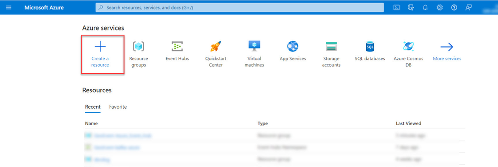

The next step is to create an Azure Event Hubs namespace. First, navigate to the homepage of Azure Portal. Under Azure services, as shown in Figure 5 below, click on Create a resource.
YujingWu_4-1669641401738.pngFigure 5. Click on Create a resource on the homepage of Azure Portal

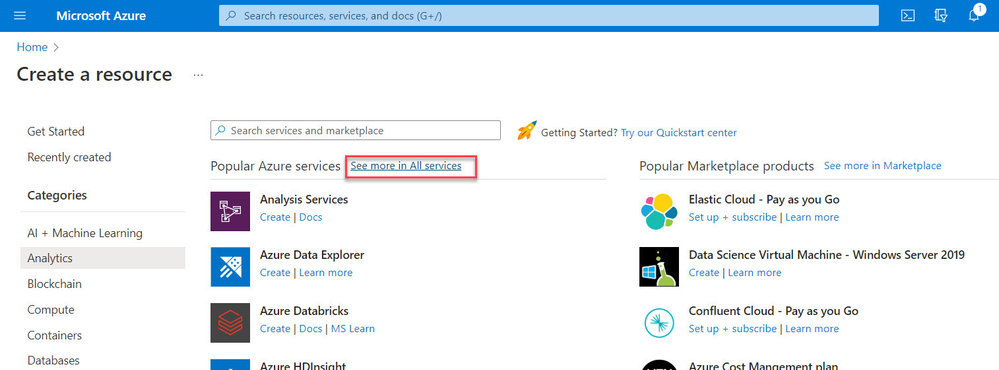

To find Azure Event Hubs, click on See more in All services under the search bar as shown in Figure 6.
YujingWu_5-1669641401744.pngFigure 6. List of available resources

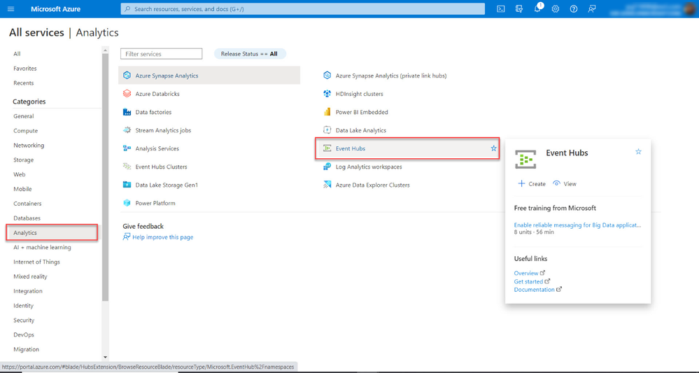

After you reach the page of All services, find Analytics among the categories on the leftmost bar and click on it. Event Hubs should show up as one of the available resources to choose from on the right.
YujingWu_6-1669641401750.pngFigure 7. Select Event Hub under Analytics

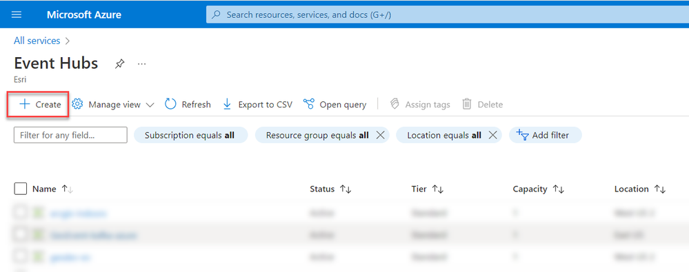

After clicking on Event Hubs, you will be directed to the list of existing event hub namespaces. On the top left corner, click on Create.
YujingWu_7-1669641401753.pngFigure 8. List of existing event hub namespaces

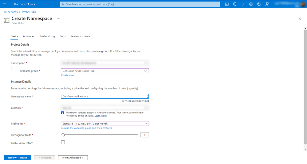

Fill out the form to create a new namespace. For the Resource group field, select the resource group just created. For the pricing tier, Standard or above needs to be selected to work with GeoEvent. After the form has been completed, review and create the namespace.
YujingWu_8-1669641401756.pngFigure 9. Fill out the form to create a new event hub namespace

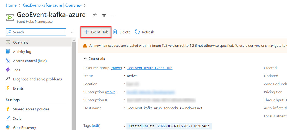

After the namespace is created, navigate to it and click on + Event Hub as shown in Figure 10 below.
YujingWu_9-1669641401762.pngFigure 10. The homepage of the newly created event hub namespace

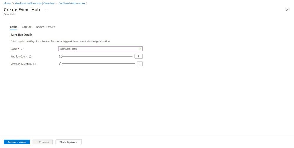

Fill out the form to create an event hub instance. This is the last step required to create an event hub instance. A more detailed walkthrough of this process can also be found in the official documentation of Azure Event Hubs.
YujingWu_10-1669641401764.jpegFigure 11. Fill out the form to create a new Event hub instance

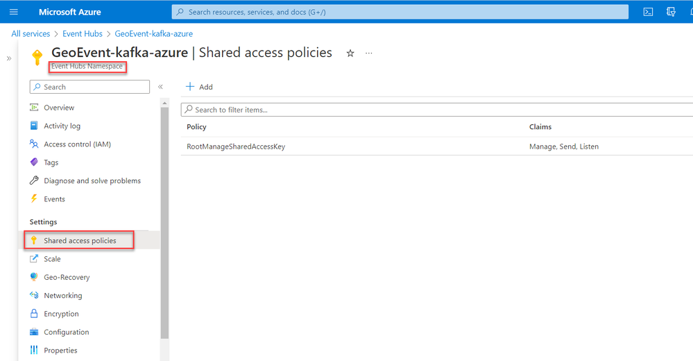

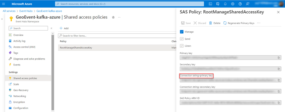

For GeoEvent to receive data from or send data to Azure Event Hubs, it needs the connection string from the Azure Event Hubs namespace where the event hub instance lives. To obtain this connection string, navigate to the homepage of the namespace and click on Shared Access Policies under Settings as shown in Figure 12 below. Make sure this is the shared access policies of the event hub namespace instead of the event hub instance.
YujingWu_11-1669641401765.pngFigure 12. Navigate to the shared access policies of the event hub namespace
Under Policy, click on RootManageSharedAccessKey. Among the list of keys, there should be a Connection string-primary key. This is the connection string that is needed to configure a GeoEvent input or output to work with Azure Event Hub.
YujingWu_12-1669641401770.pngFigure 13. Connection string of the event hub namespace

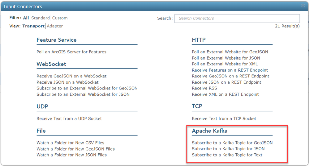

The input types that can ingest data from Azure Event Hubs can be found under the category Apache Kafka. In this blog, we will configure a Subscribe to a Kafka Topic for JSON input as an example.
YujingWu_13-1669641401771.pngFigure 15. List of available input types on GeoEvent to work with Azure Event Hubs

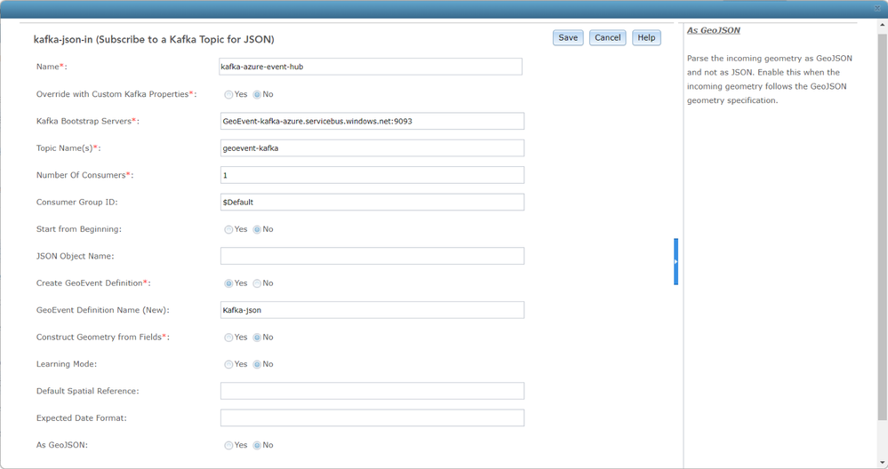

The Subscribe to a Kafka Topic for JSON input can be configured as the example shown in Figure 16 below. In the Kafka Bootstrap Servers field, fill in the hostname of your Azure Event Hubs namespace and specify the port to be 9093. One thing to note is that this port needs to be open on the firewall for Kafka to communicate with Azure Event Hubs. The Topic Name should be the name of your event hub instance. You can choose to create a new GeoEvent definition based on the incoming data or select an existing GeoEvent definition that matches the schema of the incoming data.
Figure 16. The configuration panel of the Subscribe to a Kafka Topic for JSON input

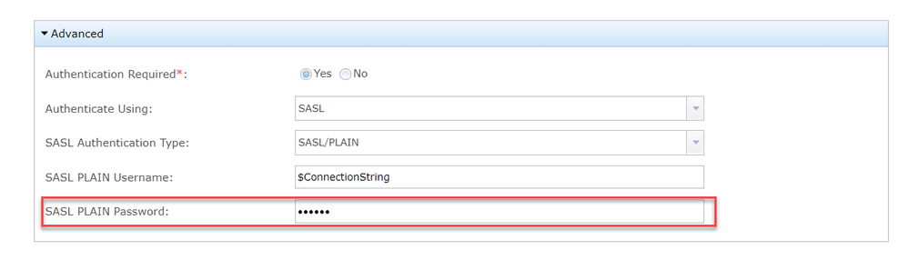

Scrolling down, there is an Advanced section at the bottom of the configuration panel. Fill out the fields as shown in Figure 17. The value of the SASL PLAIN Password should be the connection string obtained from the Azure Event Hubs namespace. Finally, click on the Save button to save the configuration. Start the GeoEvent input by clicking on the start button.
YujingWu_1-1669644266703.pngFigure 17. The Advanced section of the configuration panel of the Subscribe to a Kafka Topic for JSON input

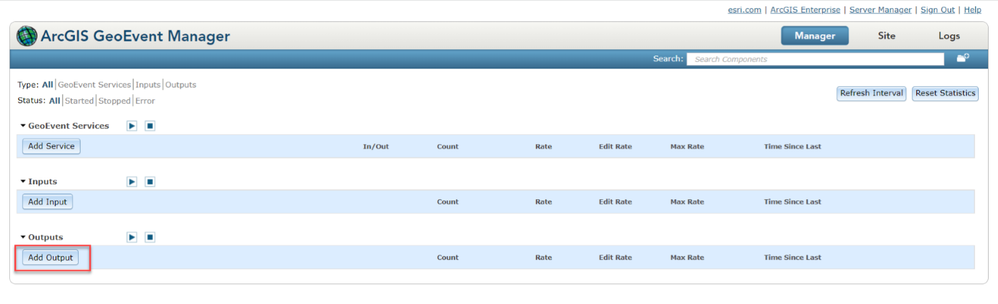

Configure GeoEvent to Send Data to Azure Event Hubs
To configure a GeoEvent output to send data to Azure Event Hub, navigate to Manager tab and click on Add Output.
Figure 18. Click on Add Output on GeoEvent Manager

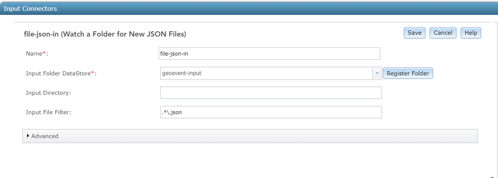

Create a Watch a Folder for New JSON Files input to read the test data. The input should be configured as in Figure 21 and 22 below. The value in the Input Folder DataStore field should be replaced by your own folder that contains the test data as a JSON file.
YujingWu_5-1669644770529.pngFigure 21. Configuration of watch a folder for new JSON files input
Figure 22. Configuration of watch a folder for new JSON files input

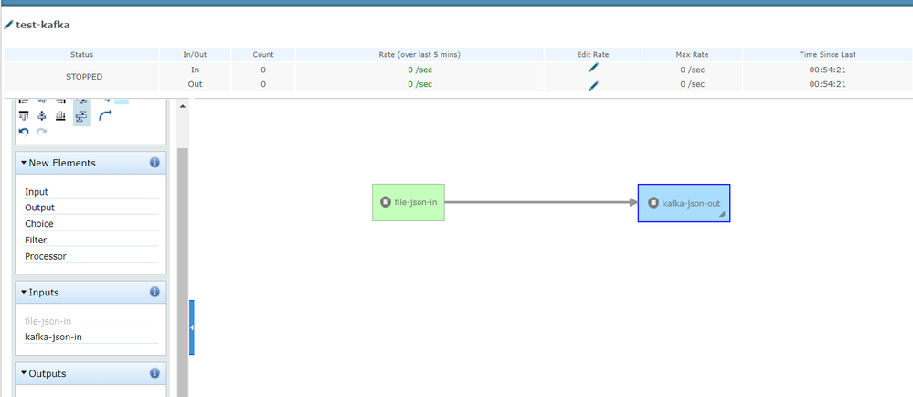

Create a GeoEvent service as shown in Figure 23 to send the JSON data from the Watch a Folder for New JSON Files input to the Write JSON to a Kafka Topic output. Both input and output should be stopped at this point.
Figure 23. Simple GeoEvent service to send the test data to Azure Event Hub

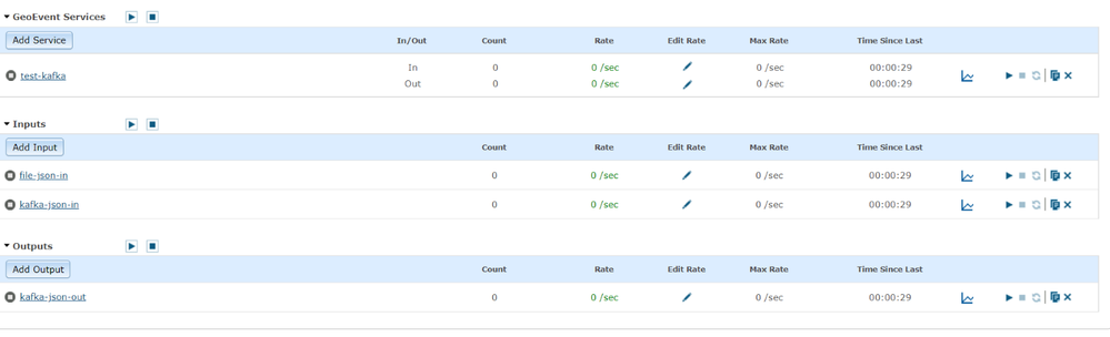

Follow the steps outlined in the previous section to create a Subscribe to a Kafka Topic for JSON input. It should be ingesting data from the Azure event hub the Kafka output is sending data to. After the input has been created, navigate to Manager tab in GeoEvent Manager. As shown in Figure 24 below, there should be a GeoEvent service, one input to read JSON data from file, one input to read JSON data from an Azure event hub, and an output that sends JSON data to the same Azure event hub.
Figure 24. GeoEvent Manager with the necessary elements to test Kafka connectors
