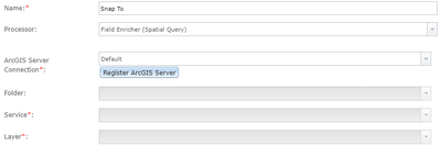

TannerSorgenfrey
New Explorer
Hi  @EricIronside ,
I am currently trying to test this workflow, as the data from motion calculator to line has a tendency to go awry.
But, after my work making the nodes and publishing the service, I am unable to navigate to the service or even any server folders after I select my server connection.
